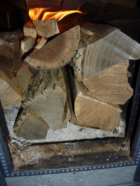

    Yep, a thermostat would be nice. Once the load burns back away from the air wash, you really need a little more air to keep the stove top temp up.

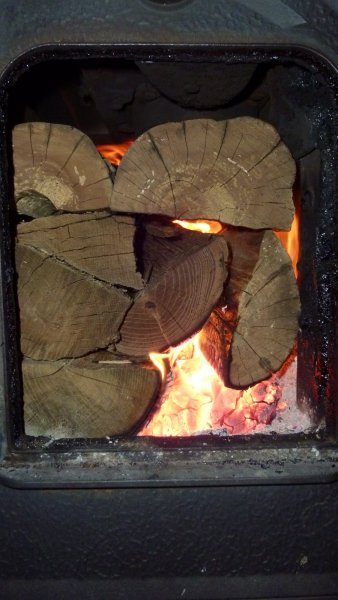

    We're gonna need some pics of the Fv or we'll have to pronounce this thread half-baked. :rofl: :lol:
    Early in the burn I can feel the marks with my thumb as I'm moving the lever but don't try it with a 500° stove. Owch! If there's some light in back of the stove, white marks should be visible without a flashlight.
    This may give ya the heebie-jeebies, then. ;) Unfortunately I can't find any pics right now of the Fireview loaded. For a 1.8 cu.ft. usable box, it's amazing the length of time that it burns on low if you jam it full of high-octane wood. :yes:
    Keystone top-down, not full enough. ;)
    Dutchwest, jammed with Dogwood. Buck 91, packed.

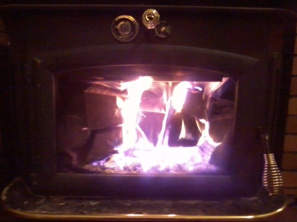

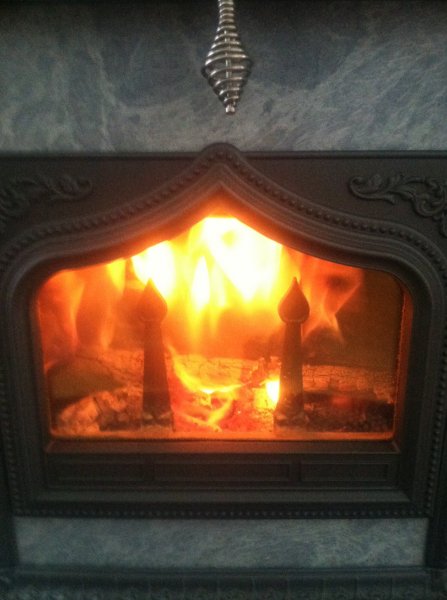

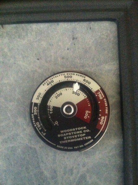

    Forgot the rules :emb:
    Here are the flames rolling down from the cat and the highest SST I have seen so far

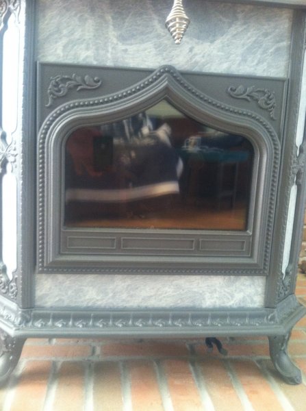

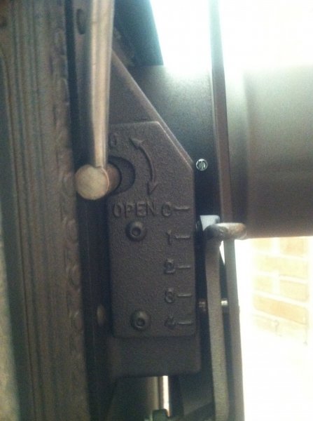

    Here is the low and slow mirror picture (hand, phone and command center view) and a view of the air setting I was using.

    550 was about the highest I ever hit with the Fireview as well. In this little place that was sufficient so I never looked to push it any higher. I usually had the air about where yours is...1 or under.

    Nice pics.
