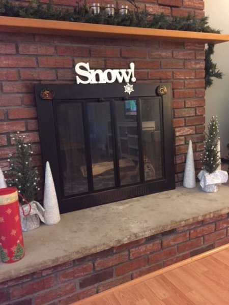

    Hello Everyone,
    I've posted before about my fireplace dilemma with installing an Ideal Steel. I'd have to rebuild the hearth in order to get the clearance I need for the stove's rear vent.
    I was checking out the specs on the Fireview and i don't think I would have to do anything to the hearth since the stove is shorter and has a smaller footprint.
    My question is how much space is needed in order to reach the controls at the back of the stove.
    These are the dimensions of my fireplace
    Hearth (brick face to the edge of the slab) 19"
    Fireplace opening is 34" wide and 27" high (might be higher once I take off the metal casing and the glass).
    I think I have enough room to drop an insulated liner down the chimney and through the damper without having to cut out the damper. I believe the fireplace was a custom build by one of the previous home owners. It seems much more heavy duty compared to some of the other fireplaces Ive had or seen in the past.

  4. papadave
    Just from the pic, doesn't look like the hearth is deep enough. You may need to put down something on the floor in front.

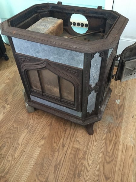

    The stove is in really good shape for its age. It just has a little bit of surface rust due to the owner having it out on his porch. I'm going to hit it with the wire brush and I picked up some brushable high temp paint so some new paint and a little cleaning up of the soapstone it should look like a brand new stove when it's ready to install.

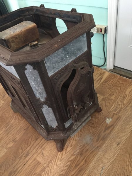

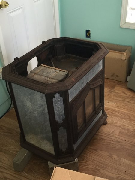

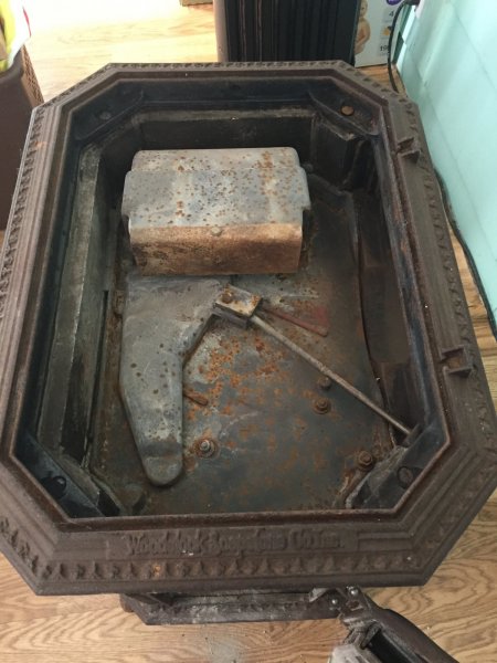

  15. BCB
    BCB
    Sep 29, 2014
    1,251
    6,263
    USA

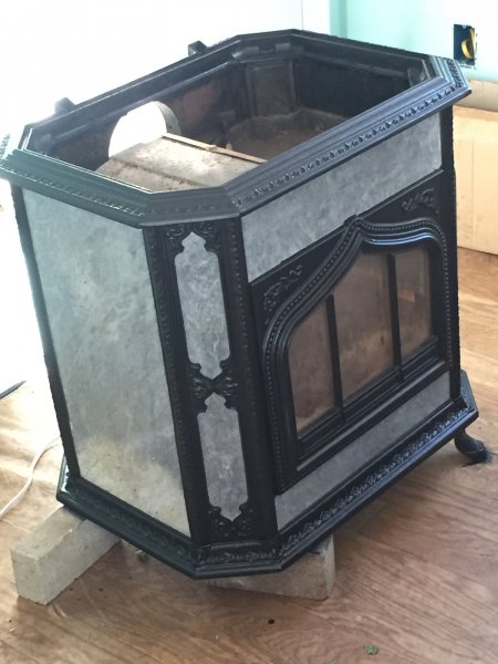

    Here she is. Getting her ready for sanding and paint today.
    RGrant, brenndatomu, LongShot and 7 others like this.

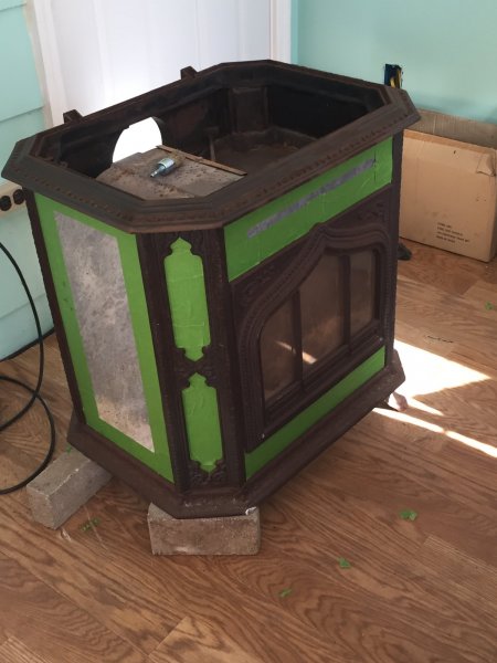

  16. BCB
    BCB
    Sep 29, 2014
    1,251
    6,263
    USA
    15171270_10209856346459092_2185775822783315908_n.jpg 1st coat went on last night. Second coat will be applied later this morning.

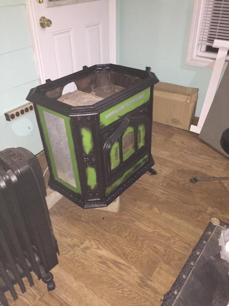

  17. BCB
    BCB
    Sep 29, 2014
    1,251
    6,263
    USA
    Paint is done. New legs and gaskets arrive on Friday. I'm going to buff the stone next. IMG_1855.JPG
  18. Backwoods Savage
    47,085
    296,914
    Looks like some discoloration on that one stone at the bottom. One word of warning about that particular stone. If any stone has to be replaced on a Fireview stove, that is usually the one. The reason for this is when loading the wood, people tend to "throw" the wood in which will hit the far end of the firebox and sometimes over time that stone will crack. So be a bit easy when filling the firebox.
  19. Horkn
    28,593
    161,927
    Wow, that cleaned up nicely!
