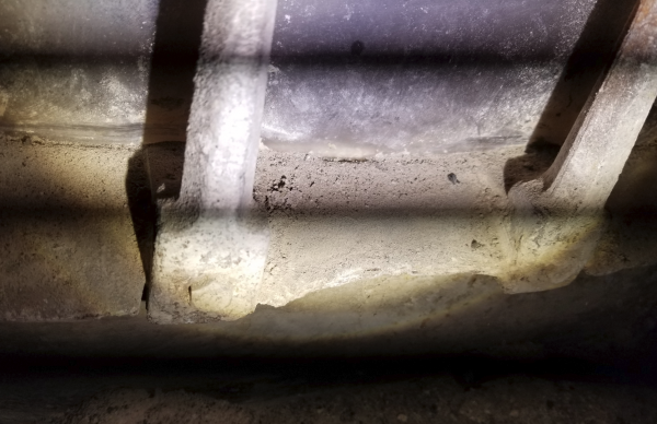

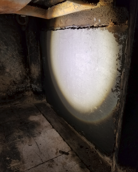

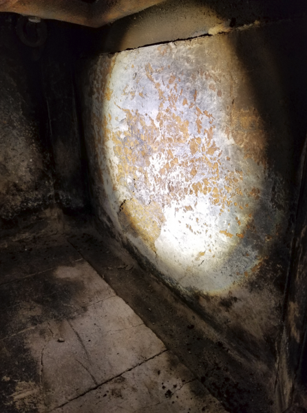

    Best guess is that I've got about 45 cords of wood through my FireView. After that many cords and years, the soapstone in back of the stove was looking pretty rough. Some of it may have have been self inflicted by raking the coals with a poker over the years, and scraping a soft soapstone surface, but I'm pretty sure not all of it. The deepest pitting at the bottom was maybe 1/4".
    Woodstock recommended a furnace cement that they sell for this. The rep tole me it's superior to what I can find locally, b/c Woodstock mixes it with soapstone dust. It was not that expensive, so I didn't dig into that statement. It looked like they mix in some type of fiber as well. It comes in a tube, similar to caulk. I did not think to take a pic, but it was very thick. At first I cut the tip like I would for caulk, but after struggling with that a while, I cut as much of the tip off as I could, and was finally able to squeeze the stuff out and spread it with a putty knife. I used about half a tube to smooth it all out, and was wishing that I had a stiffer putty knife. This pic is a couple of hours after spreading it. After a week of burning, it seems to be holding up OK, with maybe a few bulges/bubbles in the top left corner, which I maybe didn't get spread quite as well, due to the reach.

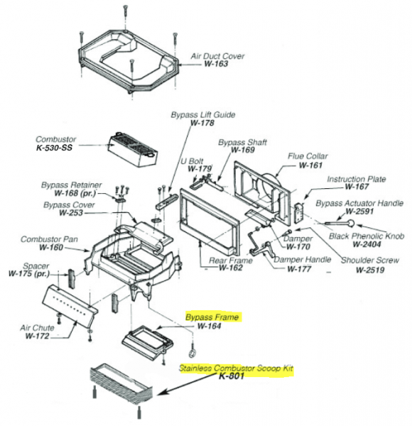

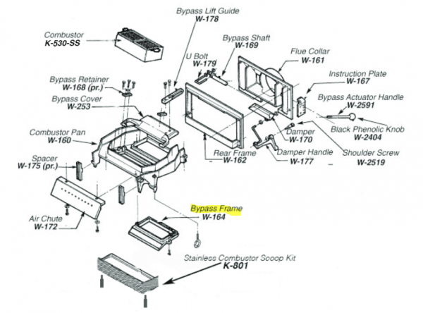

    Next was a replacement of the bypass frame. This is what the bypass cover sits on, and was described to me as a wear part by Woodstock. It's exposed to flame, and is designed to protect the combustor pan from direct flame. As you can see, mine was starting to appear a bit warped last winter, and I was concerned that it was allowing some exhaust to bypass the catalytic combustor.

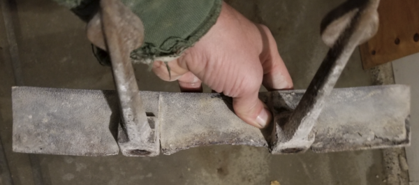

    Once out, the warping was not as bad as it looked like in the stove, but still visible. Upon taking everything apart, I think that any exhaust bypass would have been minimal, but I'm glad I replaced it, as it was starting to fail.

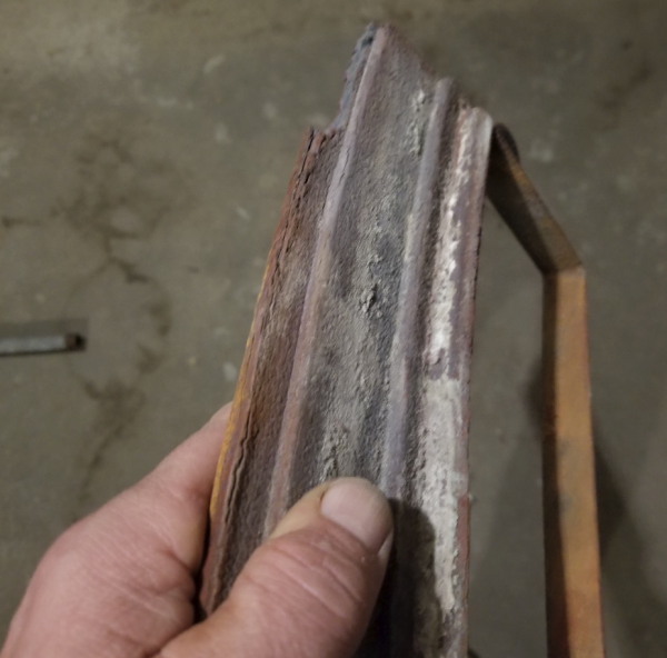

    I'm not sure if I got a cast part of a bad batch, but I was concerned to see it disintegrating.
    Getting this out was pretty challenging. I took off the Bypass Cover, which gave me access to the 2 bolts holes from the top, and filled the holes with penetrating oil for a couple of days. Even after that, I could not get one of the bolts to budge. I suspect that it would not be much of a struggle on the bench, but you have to reach 3/4 of the way into the stove, and can only get at it with one hand, so it was a struggle until I broke down and bought an impact wrench. Even then it took a while. If you're going to run an impact wrench in a wood stove with your head partially in the stove, remember to put the earplugs in before pulling the trigger. :)
    Incidentally, my 13 year maintenance was adjusting the Air Chute and replacing the Combustor Scoop Kit with Woodstock's new Stainless one.
    The Air Chute had moved over time, and I was getting more flame on one side of the stove than the other. That involved loosening the bolts, and adjusting it straight by placing pencils between the viewing glass and the Air Chute (Woodstock's recommended way to get the spacing correct and even) and then re-tightening them. Awkward, but not too big of a deal. Everything is harder when you are working on your back reaching into the stove with both hands...
    The Combustor Scoop had sagged over time as well. Not a large amount, but enough to see that it was slightly rounded when surrounded by the straight edges of the firebox. I don't have a pic, but even if it was not sagging, I'm still glad I replaced it, as the stainless steel Combustor Scoop seems like a better design.
    Again, I'm not sure if I got a bad cast batch, or this expected when exposing cast iron to corrosive wood ash for a decade plus, but I observed sagging and some disintegration in the Glass Retainer and Andirons. I'm worried that this will be a bigger project than I'm comfortable with, but will be asking Woodstock about it.
    Sagging:
    Disintegration of cast iron part:

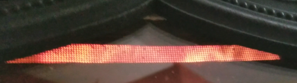

    Backwoods Savage and Oldhippie do you ever get small, rolling flames between your catalytic combustor, and the stainless steel screen? No flame rolling at the top of the stove, just a small one inside the combustor scoop. It didn't like the video, so I grabbed a screen shot, which shows what I'm taking about, even if you can't see the flame rolling.
    I noticed this twice this past weekend. Both times the stove was fairly warm, 500 degrees or so, and the air intake was choked down to close to the minimum setting, as it was getting a bit warm in the house. (but not all the way closed)
    It could be happening at other times, and I just noticed it this weekend.
    The stainless steel combustor scoop is installed correctly, and the wire mesh around it has no gaps and appears to be functioning correctly. When the air intake is opened up a little bit, the rolling flames form outside of the screen, at the top of the stove, like normal.
    Just curious, as I had thought that it was not good for the combustor to have direct contact with the flames, hence the stainless steel screen.

    I see it frequently, it's essentially pre-ignition of the gasses as they enter the high heat near the cat. The cat radiates heat up and down, back into the stove, it's what causes the rolling flames, the ghost flames, and that beautiful orange in the cat.

    I see the rolling flames, ghost flames, and that beautiful orange every time I burn... I'm just not used to seeing a small rolling flame burning inside the combustor scoop, making direct contact with the cat. I had thought that the stainless steel mesh protected the cat from direct contact with the flame.

    "Joe, I think rather than protecting the cat, it is to disturb the flame (turbulence), which can slow it down rather than just whoosing through the cat. Turbulence enables more smoke to come in contact with more of the surface in the cat. So not only does that screen protect the cat from the harsh flame, it also slows it to give time to burn that smoke. The little flame you see is similar to what happens when you see that beautiful rolling flame at the top of the firebox.
    Hope this helps.
