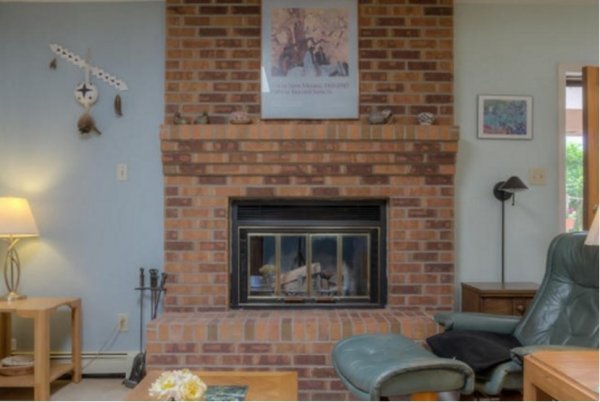

    My family is inching ever closer to purchasing our new home and I had a "burning" question to ask everyone. Pictured below is the fireplace that has been in this home for 31 years. I have fallen in love with wood burning stoves, not necessarily the one I have now, but the concept. We are planning on using the fireplace in the new house this winter, as we will not be able to afford a new wood stove so soon, but that begs the question. Which one does a better job of heating a home? I know that there will be many factors, so for sake of argument I will give you the details of our home. It is a well-insulated, brick home. One story, with the fireplace at one end of the house. I would guess that the thermal mass of the fireplace and hearth it could be better suited for holding heat for a longer amount of time. On the other hand, the wood stove may be more efficient at radiating the heat being produced out into the home, as well as a more efficient burner of wood. Any help is appreciated.

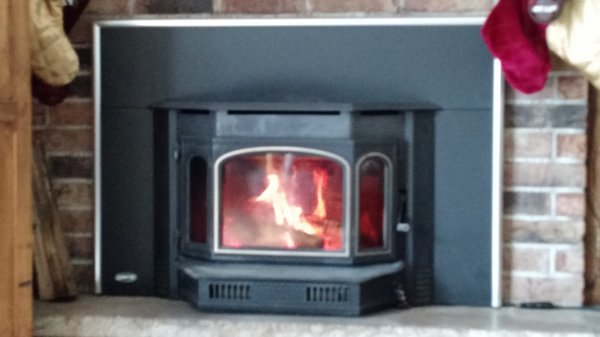

    I have owned my home since 2008. It had a brick FP pretty much exactly like yours. It may even have had the same brass doors as yours. We did have a heatilator fan FP rack that helped a bit more than just the fireplace. I have great high btu wood, and seriously, the FP was more of an as ambience thing than a heater. I once tried to heat the house with wood in my FP and left the furnace as low as possible. The room with the FP and the heatilator fan at full blast was warm, but only by the FP.
    Last year I bought a used but barely used Quadrafire 4100i insert. I installed that in early December. I used the open FP until i installed the stove, with the SS liner.
    Huge difference, massive actually. I cut my natural gas usage per day to around, $1.30-1.50 a day, from about $4 a day. We have a ng furnace, gas range and oven that gets used pretty much daily, gas water heater and gas clothes dryer. So we'll never get down to zero ng usage.
    But to drop that much dollar wise a day/ month is substantial. Because I got my stove and liner for the ridiculous price I paid, the insert already paid for itself the first winter. Actually I was ahead on winter #1 dollar wise.
    Here's my stove after I installed it.
    We went from being chilly in the house and still having a sizable energy bill, to a tiny gas bill and being downright warm. The blower on the unit works great, we get easy more heat from each log,a and we use the same amount of wood, but it heats the whole house, all the time, not just at night.
    milleo, fox9988, HighCountry and 3 others like this.

    I have a fireplace with a freestanding stove partially inside it. Looking at your picture, you have about 10 courses of brick that puts you around maybe 26 - 28" in height to work with? You are going to be limited on your stove selection due to the size of the opening. The larger the stove, the more difficult it will be to make connections to a liner. You have to figure that it may very well have to be rear vented with a short horizontal snout to the tee.
    Consideration needs to be given if you rear vent and move the stove out as much as possible out of the fire box. You need to have your minimum 16" or 18" distance ember protection on the floor from the front of the stove door out.
    I have stayed with Jotul for their quality of stoves, the short leg kits to lower the stove height to fit in the fireplace and parts availibility.
    I'm hoping down the road, Jotul will re-design their current "F" line of stoves with a cat if EPA emissions lower.
    I'll still try to convince Backwoods Savage to persuade Woodstock to develop a medium-sized, front loader cat stove to help us brick-bound burners stick some soapstone in the business end of our fireplaces.
