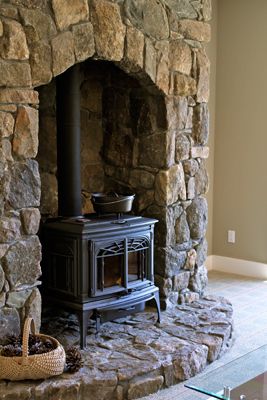

    Personally I don't understand wanting a decades old "traditional" design fireplace that will never get used as a fireplace.
    A "traditional-looking" fireplace "box" designed to fit a specific insert might make sense if that's the look you want, but an alcove can still look somewhat "traditional" and allow for a greater choice of standalone stoves and upgrades in years to come.
    As much as I do like the look of a traditional fireplace nothing says welcome to the 21st century like a big stone alcove style hearth with a modern stove placed in it. You get your formal living room/family room centerpiece and a heating appliance/solution just like in the old days.

    That is beautiful & still looks quite functional. I imagine when you get all that stone warm it does a nice job of radiating heat.:yes:

    and it has duct work to move the heat around. :handshake:
