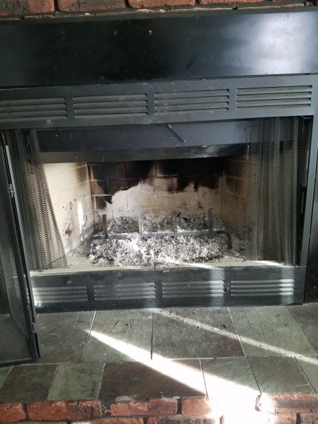

    I live in a old farmhouse with a normal open face fireplace that we use to attempt to heat the east side of the house. Only problem is that it doesn't seem to do a very good job. I feel like most the heat goes right up the chimney and can only feel the heat when hovering around the fireplace. Wonder if anyone has more knowledge to get the heat into the house better. Do firebacks or blowers work? Or do I need to purchase an insert or stove. Help! 20180108_144019.jpg

    Welcome. Unfortunately this is a common complaint with fireplaces, that is why Franklin put his mind to developing a better way. We heat a small cabin with one in the fall-- it took a lot of wood!

    Yep, most of the heat flies out of the chimney with a FP. I had a heatilator wood rack blower, but that was only slightly better than the straight up FP.
    If you get an insert, or a stove, you'll easily gain a lot more heat than with the FP.
    I've been there, done that.
    My Quadrafire insert heats my house with no help from the furnace on most winter days in Wisconsin.

    That's what I'm confused about. Does the insert have to sit in that fireplace with the bricks right now? Or do you remove all that, if so it's a huge space with 2x4 studs. I assume I leave the fireplace for extra heat protection. My house isn't very big right now but I plan on building new later in my life and would like to brig the insert with if so.

    You will need to determine if that is a prefab fireplace, or truley one built in place- picture makes it look like a prefab. REf. old -well that depends on what you consider old 1800, 1900 1950 ect by the fifties prefabs were quite common( even in the 40's for more affluent types) as such the construction supporting same may not be in the best shape, or code compliant by todays standards. there is a story behind that, that almost cost a friend of mine his home- fire started behind prefab in supporting structure. Not from flue leakage or flue fire.

    Ya it's prefab, I can't think of the model number right now. And surrounding the fireplace is just flat sheet of metal screwed in to cover the open wood space. So would you suggest removing the fireplace before an insert?

    An insert has to go into a fireplace. If you remove the fireplace, then you have nothing to put an insert in. Not all inserts and pre fabs are compatible.

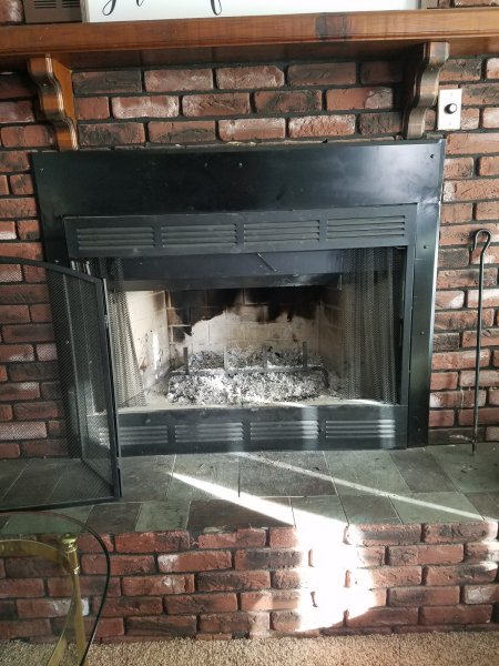

    Could you post a picture showing a little more of the hearth and surrounding area? What do you have to work with on that wall?

    That looks exactly like the prefab Heatilator we have in our living room. Except you've got bifold doors, and ours aren't.
    Our is an ambiance appliance only - if we had to rely on any heat from it, we would freeze in short order. I think it actually has negative efficiency even though it has an outdoor air intake - it sucks more heat out of the room & up the chimney than you could hope to put into it.
    I also think, unfortunately, that you would have to pull it all out & demo that area completely & start from scratch if you wanted to do something different. These things can't be swapped with an insert.

    This is all I got. Drops down about a foot to carpet. Talked to an installer that's going to give me an estimate sometime this week. He suggest the fireplace will work, just need to take out the brick lining of the fireplace.

    What exactly is he estimating on? Or it will work - for what?
    I would have to check but I don't think there's much holding the brick lining in ours. Might just be sitting there, in panels, like. It's basically just a big sheet metal box with those brick panels in it around where the fire goes.

    Not knowing exactly what you're dealing with.... my first instinct is to pull that sheet medal box out of the hole, open up some room, and check your options from there. Keeping the prefab will limit your options (space) considerably. My $.02
