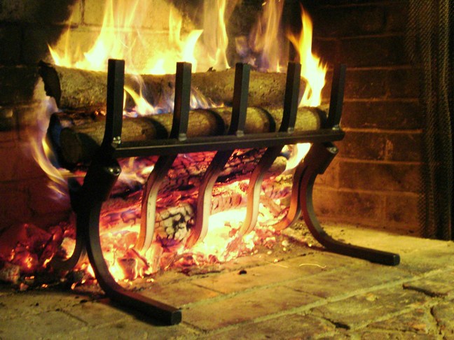

    So what are my options if I want to have small fires in the fireplace occasionally? Would installing glass doors on the fireplace help? Right now it's just a metal screen, and I was thinking glass doors might seal well enough to stop the smoke from spilling out? Or would something like this work for force all the logs to the back of the fireplace:
    It's call the "Grate wall of fire". I'm not looking for heat output, I'd like like to have a small fire now and then for the look and sound.

    I would check and make sure your chimney is clean to pull the best draft, push the fire back as far as possible and get the glass door covers. You may benefit from shorter splits too, nothing says you have to burn 16" long splits. Then see how it goes from there. Good Luck

    It sounds like it is just the depth of your fireplace. Get some properly sized andirons for your fireplace and burn it EW. I think most fireplaces were designed to burn in that manner anyway.
    wildwest likes this.

    Hmmm, I never thought of fabbing something temporary out of foil, that's a good idea, thanks!
    Other than that, my chimney is clean. The draft isn't great, but I made sure to get the wood burning boiler in the basement good and hot so the flu adjacent to the fireplace flu was warm, and it did improve the draft tremendously vs having a cold chimney. I do need to get some sort of andirons to keep everything towards the back. Looking at my fireplace design, I guess it was made to burn logs in the E/W direction.

    A friend swears by the Great Wall of Fire. It keeps the fire near the back of the fireplace and exposes a large surface area for excellent radiant heat.
