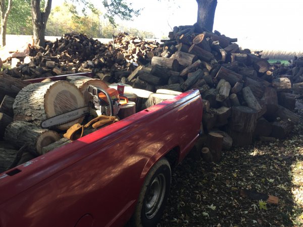

    Also if you don't want/need a saw that big, the ms250 is on sale for $300 brand new(I would get ms250 over ms251 any day!!)......you can continue to use the 18" bar size, and the saw will last you if you take care of it....I got pro saws, but I still like to take the the 250 just by itself......
    I included a pic of a few loads me and my ol trusty ms250 had before weather got cold few months ago....all shagbark hickory, even had the bar buried couple times.... I should add with this saw or any other decent brand, you can EASILY cut a truck load of wood with one tank of fuel...saw maintenance and learning how to correctly file a chain are of the upmost importance!!!!!
