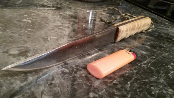

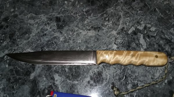

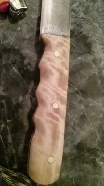

    With the way life seems to be piling up turd burgers for my lunch lately, I made it a point today to just play with getting my knife closer to done and forget about everything for a while. Sanded the handles and oiled them. Did a final grind on the edge and took it to the stones and can shave my arm bare. Far from perfect but for my first knife I am happy. Started off as an old file I found in Grandma's garage when we bought the place and the handles are from a wind felled tree that turned out to be curly sugar maple that i scrounged from the tree dump.

    Greenstick

    Your scales are awesome!! Great job.

    Very nice. That handle looks amazing.

    The file is already hard.
    What is the process for turning a file into a cutting blade?

  10. Greenstick

    As stated, it was my first and I may possibly not use the correct terminology. Took old USA Nicholson file and lit up my fire pit with a good bed of coals and heated to non-magnetic and then left it in the coals/ash til morning so it was annealed. Now that it was"softened" I drilled the rivet holes and slowly worked with a grinder to shape it. Never let it get so hot that it can't be bare handed. Leave cutting edge thick. Once rough shaping is done, I refired the pit. Got it going good and heated back to non-magnetic and kept it there for a couple minutes. Let it air cool so it can be handled, then repeat. This helps take stresses out. Third heat to non-magnetic hold a couple minutes then dunk in a metal can filled with used motor oil, quench complete. A new file should skate across the knife and not cut in. It is very hard but brittle now. To find the happy medium place knife in 450 degree oven held on its spine by a scientific formulated couple of paper clips bent to make holders so the knife won't have a hot bottom side and a cold top side and warp. Hold at temp 1 hr, turn off stove and let set in closed oven to cool slowly. Do this again. Tempering is complete. Clean knife with rubbing alcohol. Epoxy handles and rivets on. Shape/sand handle and if wooden put 4 coats of mineral oil on leaving on an hour before wiping off for next coat. Carefully take belt sander to blade to put final grind on the bevel. Dunking in water to cool often. If it gets too warm to touch or on the edge turns blue or yellow you lost the temper. Take to sharpening stone & strop until you can shave. This is what I did, weather this was right I don't know but it is what I dun did.:rootintootin:

    Greenstick those are some nice instructions with easy to understand explanations. I really do like how you clarify the annealing and tempering processes.
    However my sophomoric mind isn't quite sure what you mean by getting it to a "non-magnetic" state.
    Is that as simple as heating it and using an extendable magnet to touch it and see if it 'grabs'?

    You got it! Once steel gets to a dull cherry red, i can't remember the exact temperature, steel no longer will attract a magnet.
