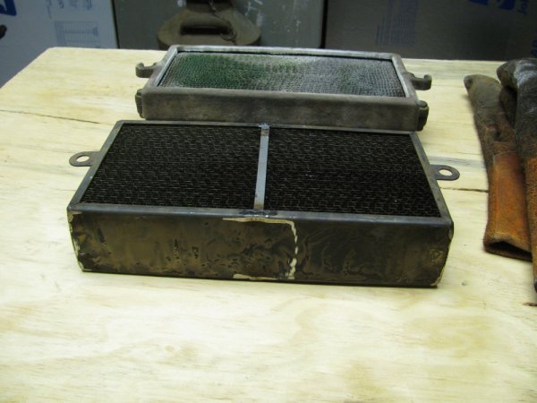

Finally got the new cat for the Fireview
Discussion in 'Modern EPA Stoves and Fireplaces' started by TurboDiesel, Feb 16, 2014.
  1. TurboDiesel
    16,198
    97,198
    and its a little different, but in a good way.
    The new cat doesn't use the cast iron housing. It has it's own steel housing and just replaces the old housing.
    check it out.
    BrianK likes this.

    Interesting.. I see a center support on the new cat. Is there a support on the other side too? They might have done this to prevent or reduce sagging..

    146
    The new one looks identical to what is in my IS beta stove. I believe they are the same part.

    Yes, this is the same cat.
    Tim, I hope you used the shipping bolts to hold that thing in place. It is so light that the bolts surely are needed. I have not yet put ours in but may soon.

    Yes I did use the shipping bolts as recommended. The new cat is so light it wants to slide out of the opening. They give you a tiny packet of high temp never seize to put on the bolts also. Bolts only need to be finger tight plus a 1/4 to 1/2 turn, just enough to keep it from moving.
    Hi Raybonz
    I did look at the bottom but don't remember if there was a support. I will check the next time I have it out.

    My 2nd Gen SS came with shipping bolts for the KS. Definitely lighter than the 1st Gen with the cast frame.

    I really like the new design, with straight rows and it looks like the cells are more open. I think with the frame being stainless, there will be more even expansion and contraction hopefully keeping the interam gasket intact longer.

    The instruction sheet says the frame is steel.
    I'm sure the catalyst will wear out before the steel frame
