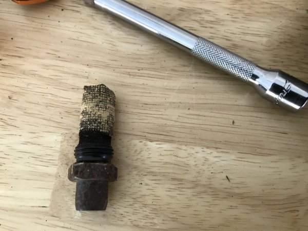

    String trimmer needed a new primer bulb. Put in a new one but the thing just would not start.
    It is quite old so I figured it needed a new carb diaphragm. Watched Steve (Steve's Small Engine Saloon, best small engine how to I've found) and did up the carb. The old diaphragm was definitely getting crispy, so it was a good move. But it didn't work.
    Put the reed valves and gasket in backwards the first time, but that was easy enough to fix. Didn't start.
    Figured a new fuel filter after 15 years wasn't a bad idea so I did that.
    damm think still wouldn't start. Checked the spark plug. Sparking OK, but I put in a new one just because. That didn't help.
    Air cleaner good, carb rebuilt, fuel filter good. Fuel lines all looked good. Started getting a bit annoying.
    If air gets in and fuel gets in and spark goes, what's left? Maybe air doesn't get out.
    Mud dauber nests in the muffler! Spark arrestor totally occluded.
    Poked the nests out, pulled the muffler, hosed it out, pulled the spark arrestor, hosed that out, and reassembled.
    Success!!
