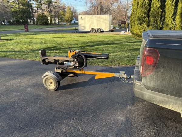

    I’ve been eyeing splitters for awhile now and this one popped up on Marketplace in our town. The guy had two splitters listed and I messaged him about a Champion 27 ton first. Never heard back until it was marked sold. Messaged him about this one Monday, we agreed to meet up Tuesday evening. Ironically, he was just a few miles from the house and not far from Brad’s orchard applewood score. He had a lot of interest in the first splitter and two or three people behind me on this one. Keeping in contact with him paid off.
    Story goes he bought this off his buddy 3-4 years ago, used it to split wood, stored under the deck and was selling it because they switched to pellets. The other splitter he was selling for another buddy. He said I could bring a few rounds to split. The engine fired up in about 3-4 pulls from cold. Went through the Ash and Maple no problem. He was firm at $650 and I took it. The fact that it has a Honda engine was a big selling point for me.

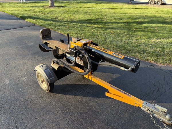

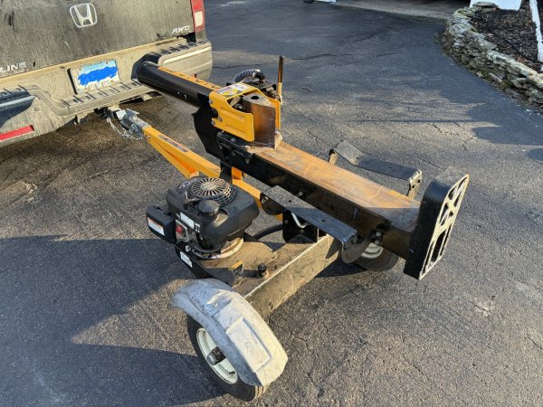

    A few pics from when I got it home:

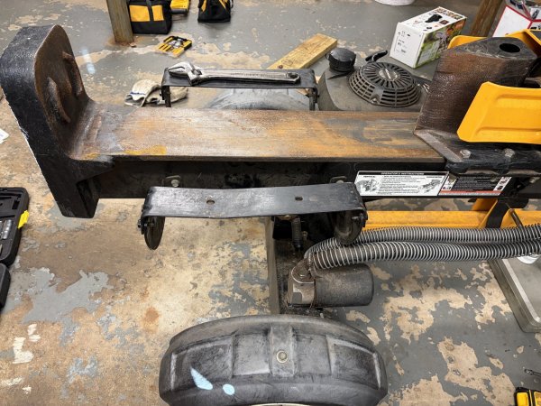

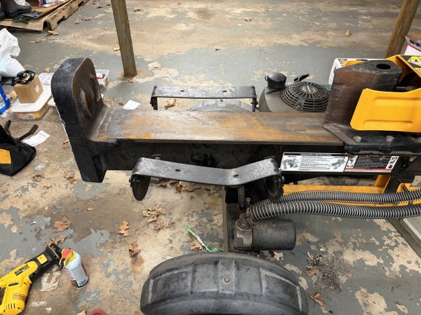

    So I got to work over the last few days giving it a good once over.
    Straightened out the fender mounts and was able to straighten out the log catcher on the operator side. I pulled that off the splitter and some time with a dead blow hammer got it about 90% of the way there:
    Then, I loaded up the parts cannon! (Not pictured, the quart of synthetic 10-w30 I also bought…yes the garage is a mess! Slightly cleaner this evening)
    I ended up pulling the wheels to inspect the bearings. Non Operator side was fine, but I still cleaned and repacked the outer bearing. Operator side needed a litte persuasion to remove. Once out, the bearing was pretty seized up. I’m guessing they were never serviced as it still had white grease in it. I was able to get it freed up, but opted to grab a new one from one of the local auto parts stores that dot our town. Packed that and reinstalled. I don’t foresee me doing a lot of towing this (it’ll be trailered back and forth), but better safe than sorry.
    It was a bit low on hydro fluid, so I added some more and cycled the cylinder a few times before each refill. I put in a new air filter, spark plug and changed the oil to synthetic. The Fluid Film is for the beam. I’ll clean the up then coat it.

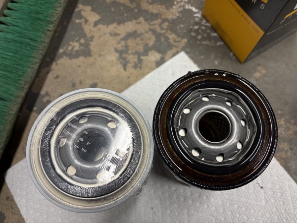

    Now, my question….I used AI a lot for part numbers, info and whatnot. It’s been pretty accurate…except for the hydraulic filter. I was typing away at the parts store as the first filter it recommended was clearly automotive. It then gave me a part number to cross reference and the guy at the counter came up with the Wix 51259. I got home, pulled the filter and compared it to the new one. AI then told me it’ll work, but it’s not ideal. LOL!
    Anyone have any guidance here? From some research, this is a pretty common splitter that was made by Troy Built and rebranded as a Cub.
    Looking forward to testing it out in VT as I have a bunch of rounds to split.

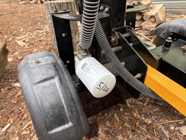

    We've talked about them before, but it's been a while...some models it's tough to cross the filter exactly.
    The bigger the better, and as long as it doesn't have much finer filter media, it should be fine....if it has finer filtration it will bypass a lot more, or in cold weather you can even blow the filter up too.
    I looked the 51551 up...10 micron, too fine IMO...20-30 would be much better.
  6. brenndatomu
    24,315
    157,327
    Wix 51552 is 20 micron, 51553 is 33 micron...those would probably be better choices.
    Any of the 3 are all good hydraulic filters that are commonly used on much more complex/expensive hydraulic systems than what a log splitter is.

    brenndatomu, I think that 51552 will be the Goldilocks filter for this unit. Thanks! I’m going to pick one up next week.

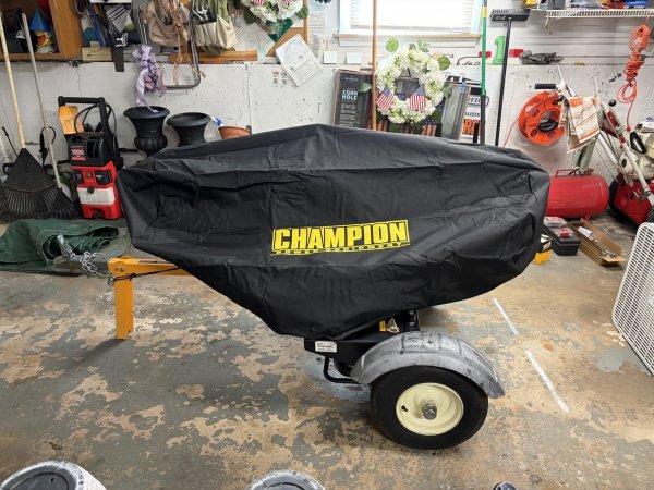

    And because everyone likes pics…..
    Test fitting of the cover. Yeah, wrong brand, but the wildlife in VT won’t care. ; )
    Made it up to VT no problem! Trailer Swift was a big help. Cover is on it now as we’re supposed to get rain overnight. Hoping to get out tomorrow and run some rounds through the splitter.
