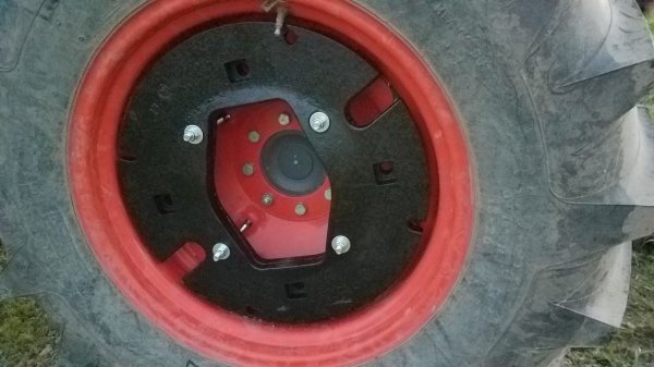

    My Kubota MX5100 has needed a bit more rear ballast since I picked it up in 2013. I loaded the rears with Rim Guard when I bought it. It helps a lot but always seemed to need a little bit more. I refuse to pay $2/# at the dealer. My scrapyard guy had a Farmall H come in a year or so ago. I paid $20.00 for the two rear weights.
    The only problem was they didn't have the same bolt circle and they barely fit inside the rim. While I have a full machine shop at home, my son is taking Precision machining and Engineering at our local Vo-Tech campus. The instructor said he could bring in a project from home at rhe end of the year.
    Bingo!!!! Of course they do things the right way. He had to make a fixture to mount the weights to a rotory table, machine about a 1/2" off the diameter, locate and drill four holes on 13.5" centers. He learned quite a bit about machining cast, to the dismay of a 5/8" carbide endmill. He finshed them Friday.
    I painted them today and we bolted them up tonight. I'm anxious to start moving logs and see how it works. And, yes...I know they are mounted with the backside out. The reason is that it sits deeper into the rim this way. Yeah, it's only a half inch deeper, but if I come across two more I can mount them conventionally and they won't stick out past the tire.

    Your son did a great job!

    That's a win all around. Looks good.

    Wow very clean job! Looks like factory fit and finish. Your boy did a nice job Casper!

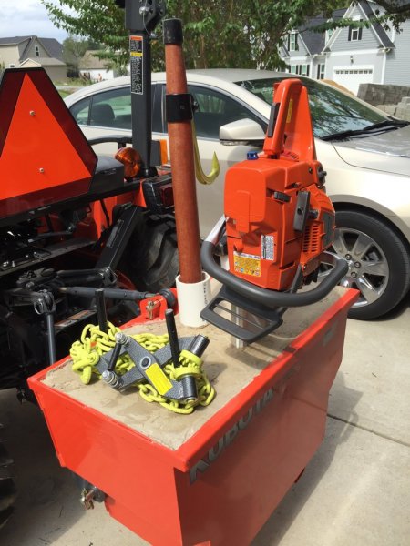

    Those ballast boxes are great, the only problem for me is that some of the woods I get in are a bit tight. If most of your time is in the open they're a great option. I have throw the brush hog on when working a tree or fence line. I'm hoping with about 900# of Rim Guard and 280ish pounds of cast, I should be good. There have been times that the rear just barely wants to raise, especially when loading logs into the dump and a heavy logs rolls towards the tips of the forks. There are a couple dents in the floor from a quick unload. I try to cut larger logs to a point they are not hard to handle but I've mis-judged the weight of green wood a few times.

    Although I don't currently have a tractor of my own, I spent a good deal of my youth on my grandpa's dairy farm. I'm sure you already know what I'm going to say because you seem to be pretty experienced, but for the uninitiated reading along with us I'll mention what my grandpa taught me.
    He explained it like this to me loaded tire ballast help balance the fel load and lower the center of gravity only. However, they do nothing to remove stress from the front axle. Three pt. hitch ballast turns the rear axle into a fulcrum and actually relieves stress on the front axle. You obviously knew this because you mentioned using the brushhog when you can.
