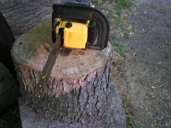

    My recent Mac 610 CL score (just like the one I bought new 21 yrs before) has the oil cap in a annoying spot behind the chain brake -only saw I have that's a real pain to fill.So I keep a spare 1quart motor oil bottle filled with bar oil for that purpose .Regular gallon jugs are too cumbersome,plus a funnel don't always work so great either,especially when you just need to pour a few ounces at a time.
    I also have a smaller dishwashing soap bottle with the pump that works great too.

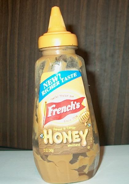

    For bar oil I use a French's mustard squeeze bottle.
    It has a cone shaped twist to open spout.
    It has a large mouth so it is easy to refill from a gallon jug.

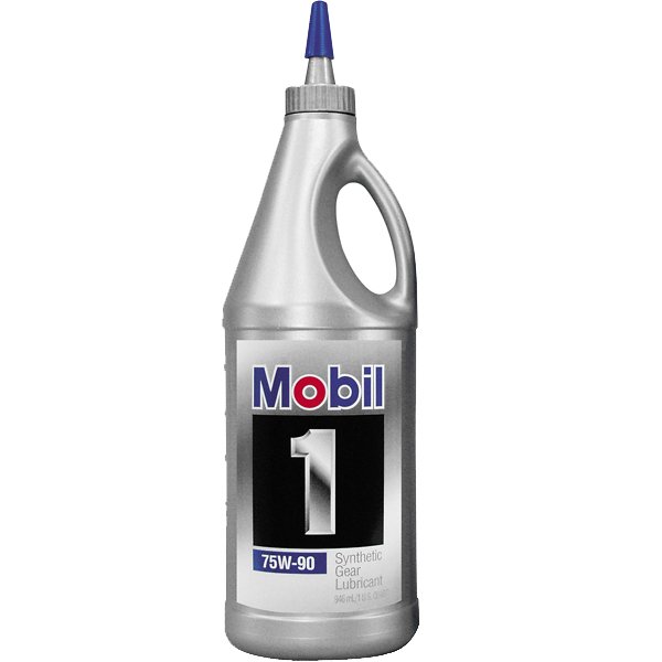

    For the oil , a gear lube bottle works grrreat
  19. Oliver1655
    Oliver1655
    Oct 30, 2013
    562
    982
    Central Missouri
    Sometimes the lid/pointed cap of the gear bottles will screw onto your bar/chain oil jugs if you don't want to transfer the oil.
