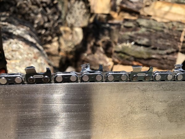

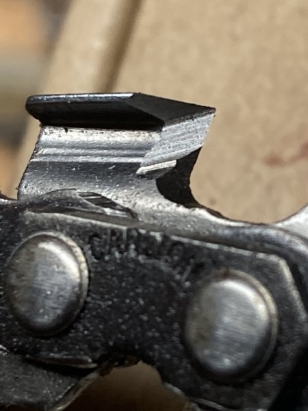

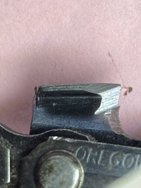

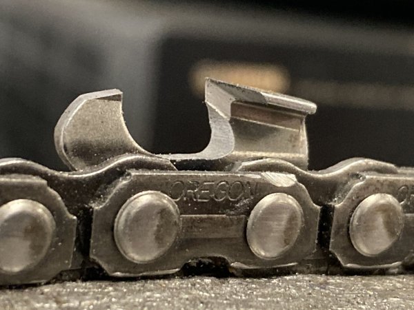

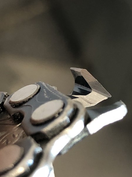

    I consider myself pretty proficient with a file:
    That being said, grinders are super consistent, precise and much faster!
    325E37F1-F35A-4F84-B6E4-EAF081207E32.jpeg 385F832E-BD77-4663-BEE7-F316E73A6878.jpeg F649A622-5668-4AB0-AB6B-C66CC30C2A5B.jpeg
    “sharper” with a file, meh. I can create a pretty delicate, razor edge with a wheel and a file. I think you’d be hard pressed prove one way or the other.
