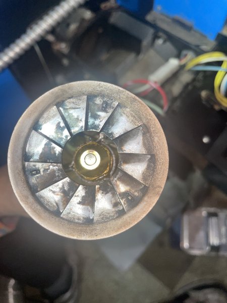

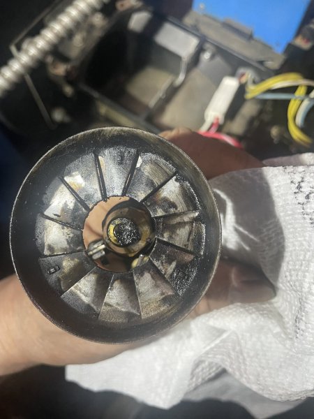

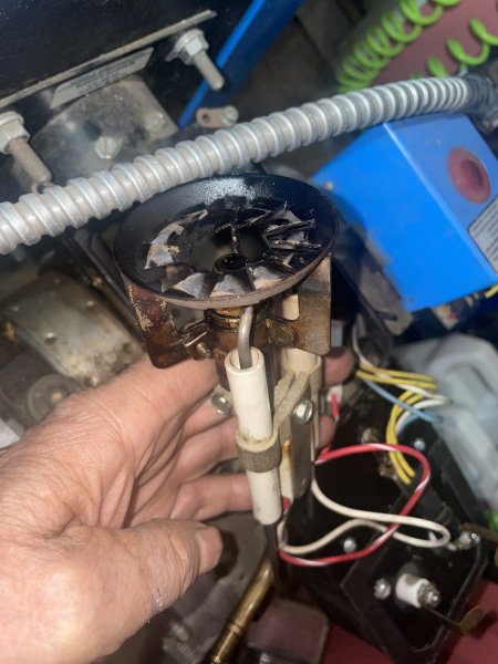

    In this case the none of these items were that old, therefore I pulled the nozzle for examination. It was really fouled and the turbulator was quit oily. No wonder the photocell tripped because the spray pattern must be way off?
    Therefore I cleaned them both, the turbulator and the nozzle, in the the nozzle assembly.

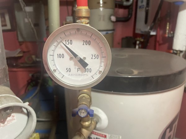

    The boiler fired up fine and has been working well for the last few days. The last pic is the temperature of the SuperStor tank.
