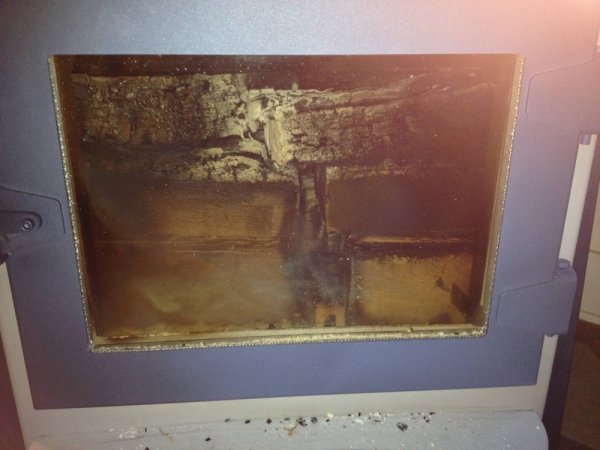

    Two hours into burn on 10% air, not much visible activity in firebox, stove top temps have leveled out around 350. There is a hot spot just above the middle of the door on the front of the stove just below the lift off top that is consistently running around 450 on the IR thermometer. Most of the heat from this stove comes off the door glass and the top front, not the top rear near the flue collar.
    There's a little soot on the bottom left corner of the door glass, and the bimetallic coil for pre cat air is just a little open now.
    Outside temps now 35, room temps up to 74 from 68 at 3:00.

    Brian, I am wondering if you have double checked the door gasket because of that dirty glass in the same spot? Also, making sure the latch is tight when you close it? One has to think there is some air coming in there but still not a big deal; just bears watching.

    The thought had occurred to me Dennis but it closes up real tight/secure. If you look at the first photo on this thread, with the door open, you'll notice soot on the stove itself in the same area. I'll keep an eye on it. Adjusting to latch tightness looks pretty straight forward, just loosen three bolts:

    At four hours into the burn, outside temps now 27, room temp now 73, stove top still at 300, no real change to firebox appearance from last photo, no visible activity in firebox, hot spot just above the middle of the door on the front of the stove just below the lift off top at 400, flue temp on probe thermometer 375.

    Now smoke from the chimney right? The cat is engaged? How much of the wood have been eaten? Does it look much different than your original photo:

    Smoke was completely clear within first twenty minutes of lighting the fire. Cat was engaged at about ten minutes after ignition. Not much change in amount of wood. Here's a current photo at five hours into the burn. The two pieces on top front were a piece I split in half longways to load up to the top of the firebox in the front. One of them just started to coal and a piece broke off but the rest of the logs are still 95% intact.

    That looks pretty damm good. So, you are about five and a half hours into the burn. I'm hoping this stays chunky through the 17 hour mark which would be 8AM.

    But, I do suspect this load will break down sooner than it should since the "splits" are short blocks.
