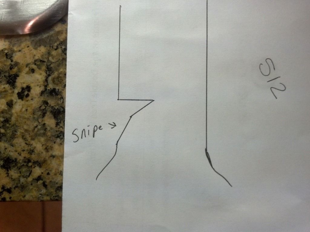

    That's a humboldt face. Here's a drawing of a humboldt with a snipe on the bottom of the stump.

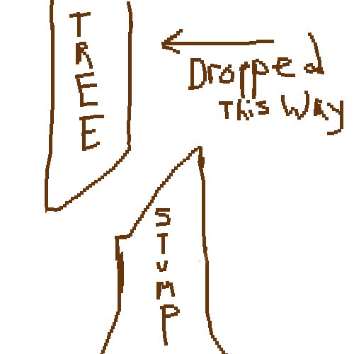

    I did a computer drawing to show what I'm seeing. Stumps left knee high.

    Did you leave the notch out of your drawing Nate or was there not really one visible? Either way, I can't see how these were safely cut with the methods you describe. I've walked through the woods around here shaking my head at some of the stumps.
    mdavlee likes this.

    Sort of a notch on the left side.
    The trees are dropped in every which direction (making it real fun to limb and skid)
