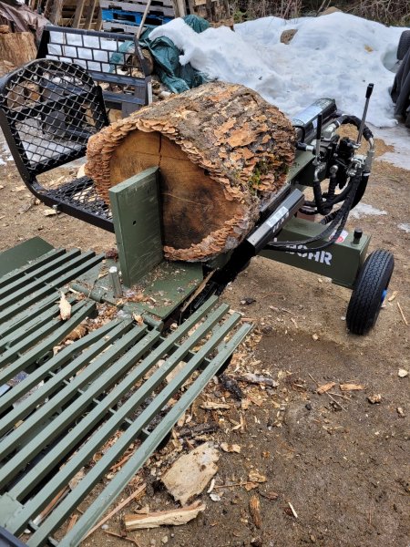

    I have a Full Boar and although I haven't timed it, the cycle is definitely slow. When I purchased the splitter, I pretty much knew what I was getting and only planned to upgrade a couple things (hubs/wheels/tires for added height, engine guard, better push plate grip) however I have seen quite a few people buy them and then dump another couple grand or more into them. Not worth it in my book. If you plan on running it a LOT (especially in hot weather as the hydraulics tend to run on the hot side) then I would say don't purchase one. The cycle time doesn't bother me and I don't split for long periods anymore due to heath. I also don't split as a business. The Full Boar is basically a budget splitter that has the bonus of a hydraulic lift (which is pretty much the only reason I got it). (The pic is of mine.)
    There is a guy over on the FB Full Boar page that has done a bunch of modifications to his (changed motor, added a cooler, upgraded other components) and this is a recent post:
    Engine guard, 3/4 push plate, predator 420, vevor 22gpm pump, hydraulic filter, cooler powered by Milwaukee battery, weld on jack. Bolted sorting table support to the table so I could change jack. I believe the valve and hoses for the wedge and lift is too restrictive and limits unloaded cycle speed but under load it seems to push faster than a stock unit I may eventually change to a bigger valve when I do an auto cycle upgrade. But for now it’s been a simple budget build.
    Machine $3600. Wife’s military discount at HD
    Predator 420. Already owned ($380)
    Vevor 22gpm Already owned ($212)
    One hydraulic hose from cooler to filter. $78
    Cooler. $160
    Milwaukee18v- 12v adapter with low voltage shutdown $25
    All return line fittings were sourced from my work at no charge
    Steel also sourced from scrap bin at work.
