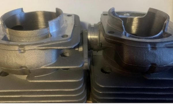

    Any tips you can give ? Did you also clean up the skirts on the cylinder similar to the attached pic ?
    From what I've read / heard there's around .050 of squish with the base gasket is .020 so by removing the base gasket that gets you down to about .030 of squish which most folks say makes the saw run much better. I've seen on videos on how to check squish. Is there a way to check and see if the piston is going to hit the crankcase ?

    It won't be the piston that is the potential issue, its these...
    They have the potential of bottoming out in the crankcase without the gasket. You can make measurements with the depth side of a pair of calipers to verify.
    brenndatomu and morningwood like this.

    I should have read your post much closer. :doh:Pictures are worth a thousand words. Thanks for the picture, that makes sense now.
