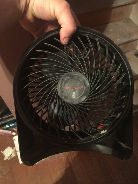

  10. creek chub
    creek chub
    Jul 11, 2016
    319
    1,471
    Va
    I was able to get a small Honeywell desk fan from staples for $16. I will try it out and experiment to see what works best for my house's layout which isn't too open.

    My stove room has two door ways and is a sunken living room that has two steps. Both doorways have bulkheads that extend down about 18" from the ceiling. In my first attempt I didn't notice much air movement with the fan. I had it sitting on the floor about 12' from the stove room. I suspect the bulkheads are trapping the hot air and acting like a damm
