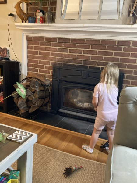

  10. mrfancyplants
    mrfancyplants
    Mar 21, 2019
    937
    5,171
    South Carolina
    I know, not a lot of space to work with. That’s why I was thinking the ash trap could be ducted to bring up air to the blower. image.jpg
  11. Trailman
    Trailman
    Oct 14, 2021
    23
    104
    Kansas City
    That’s helpful to see. After seeing the picture, I would suggest having someone from your local insert dealer out to see if they have any suggestions. The open floor plan between levels I think is going to make it almost impossible to keep the warmer air from rising and cooler air from sinking. If you do get the basement comfortable, it’s probably going to mean the rest of the house is too warm unless you can seal off the basement to keep the warm air down there.
