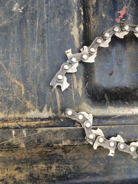

    IMG_3123.JPG Just as the title says, was cutting and all of a sudden there wasn't any chain left on the bar. It just snapped. Never had that happen before and I cut a lot of wood. Decided to call it a day and ended on right then and there.

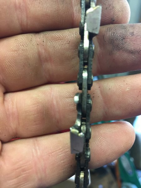

    If I had to analyze the chain it looks to me from the pics that the drive teeth have some pretty good wear and also the bottoms of the drive links are worn and could be mushroomed out some from leaning on it when cutting. Also was that chain ever put on backwards by accident.

    I see the issue .. first off glad you didn't get hert. With close inspection . Rakers are to high for how much sharpening went on .. in turn means you were pushing hard to get to cut at high rate of speed putting to much pressure on chain and bar and not enough bite on rakers. This will heat up chain burn off oil and snap a link . I think most of us learn all this stuff just like you are your not alone. And buy looking below rivets there's not much wear on chain . I wear them down to rivets and they don't snap I will dig some of my old chains out and snap some pictures of real lower rivet where. Keep safe grind your rakers

    But beyond what others have said, that is ONE DULL CHAIN! The teeth are rounded right over! Yikes.

    Chain wasn't the sharpest but it sure wasn't rounded over dull. It was cutting through some poplar with ease the few logs beforehand. It broke in a 3-4 year old Norway Maple which seems to harden as it gets older.

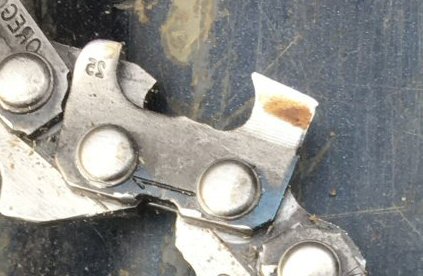

    In my honest opinion, the sawchain was. If you look at the teeth they are actually rounded over pretty good and do not come to a nice sharp, point.
    I am in no way passing judgement, I have hit dirt, waited to get through a twitch with a dull saw myself, but there is no question, (I went back and looked), that chain was pretty dull.
    I isolated a single tooth to highlight how rounded over the point was. Add in high raker height and it can be seen why the chain was stressed.

    Why were chips still flying?
