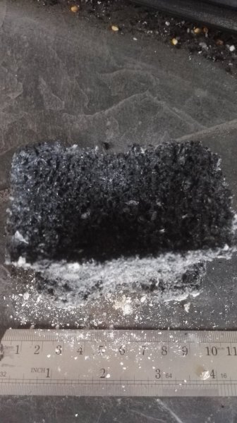

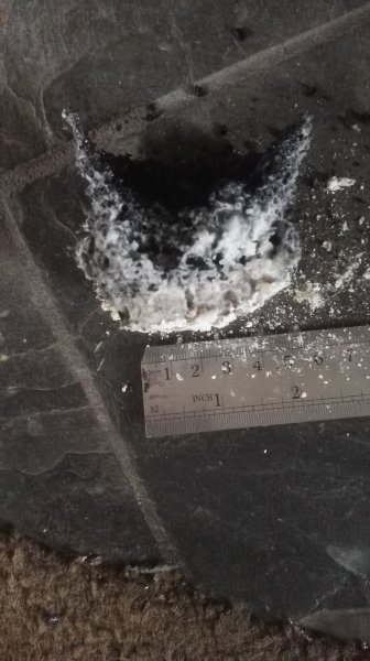

    Out here it is a badge of achievement for big clinkers. Like growing giant pumpkins...
    Here is the one I pulled out today after 20 hours. Mighty proud of this bad boy. 44lbs of wheat reduced to this 6 oz behemoth.
    The white stuff on the base of the unbroken clinker at the top is the paper pellets we use as the ignition source. It leaves a bit too much residue so this time I am just using wood pellets to light which should let the clinker get even bigger.
    The bottom pic is the clinker broken in half. That formation is almost perfect :thumbs:
