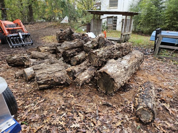

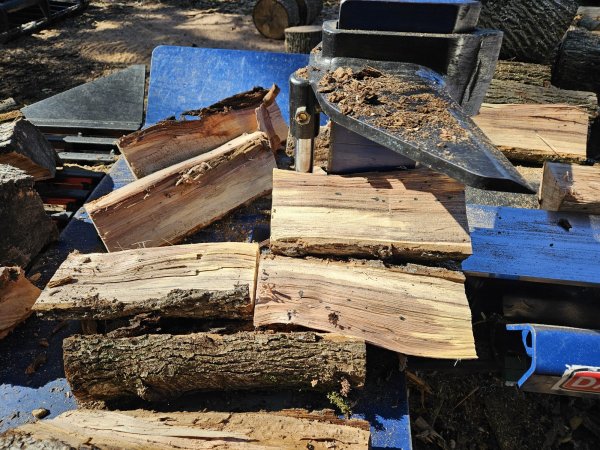

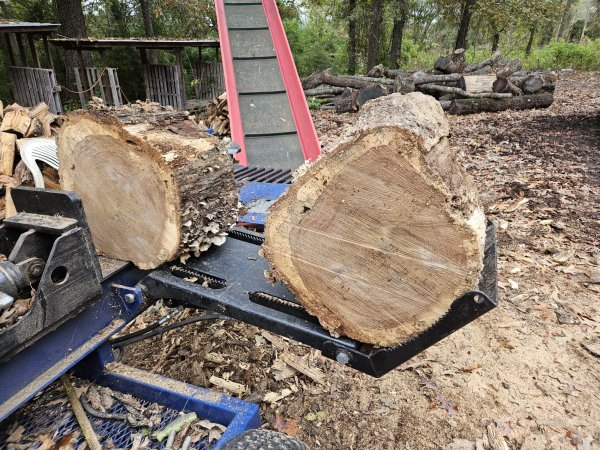

    What species do you think you'd store as logs or rounds for 1 year? Maybe 2 years but 1 for sure. As an experiment.
    I know a seller here whose family does some logging and I think he gets free logs. But he stores those entire logs to 'season.' I have seen him cut some rounds and store them but mostly it looks like 8 ft logs. When October rolls around, he bucks them into rounds and splits and sells. So, the buyers are getting his 'seasoned' wood that isn't seasoned, lol. A little, but probably not much?
    I have seen him use this strategy for ten years now. And I know some buyers complain about his wood. But he finds new buyers every year on FBMP and delivers to the city 40 minutes away.
    If you were going to do that and your aim is to provide the best firewood you could sell, whether they have to store it a year or not, what species?
    1 red oak (southern red oak here, maybe it's about the same as northern red oak)
    2 white oak
    3 hickory (I think we have mostly mockernut / bitternut / pignut here)
    You could name another species but these are the three most prolific hardwoods in this area. And they all make great firewood.
    The benefit of this to the seller is he touches the wood only once. He does not stack. He splits those rounds into giant piles of splits and when he gets an order, he stacks onto his delivery trailer.
    The benefit to the buyer is... I can't think of one, lol. (Poorly seasoned wood.)
    A negative to the seller is his wood could get punky. He sells only oak far as I can tell. I have noticed that some of his logs/rounds, the sapwood gets punky on him. I don't know if that is after one year or two.
    Negative for the buyer is wood that won't burn well this year.
    If I were to try this and the wood became 'ruined' forever, that would be the end of the experiment, lol. Logs or rounds? I'd think rounds because they might be a tad more 'seasoned' than keeping in log form. What species, any opinion?

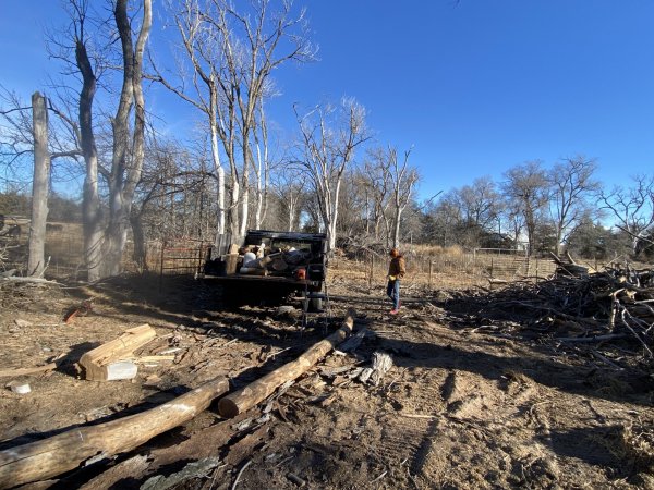

    Logs do not dry, certainly not in a year, and definitely not oak...heck, oak doesn't wanna dry even after split!
    Anyone selling firewood that was just split from a log should be advertising "green" firewood, not "seasoned"...whatever that is.
    The only way you get dry ready to burn firewood from a log is if it was a dead standing barkless elm.

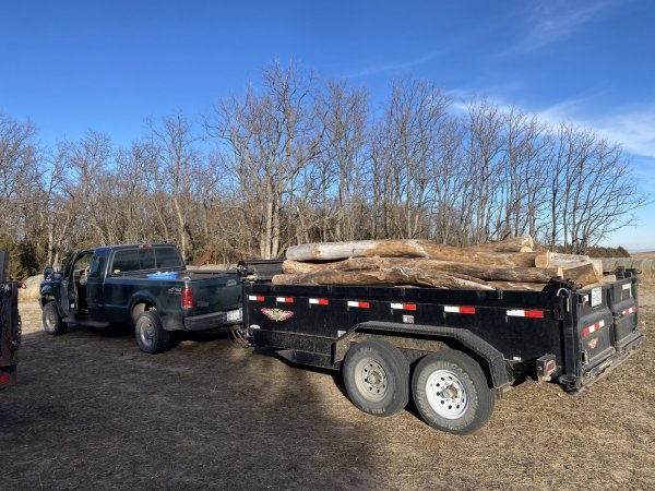

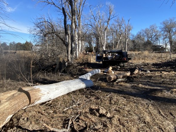

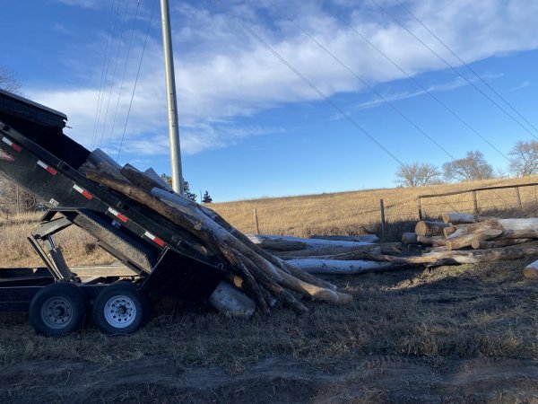

    It’s common for me to let elm that was taken alive to sit in logs or rounds for a year at least, then the bark will fall off easily. If’n I leave em in logs a year, then buck them into rounds, then give em another year and they can be split reasonably. But still need another year to dry, and still won’t burn as well as one that died from natural causes and lost its bark before it was taken down.
    Hackberry has a short shelf life in the rounds or logs, especially if it’s in contact with the ground!
