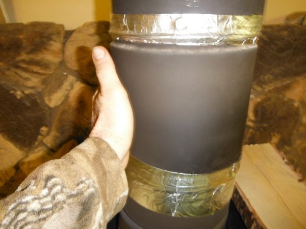

    BK propaganda says 150° to 300° exhaust temperatures for normal operation.
    Just too these pics of my stove pipe.
    2.5 stat setting, fire from last nights 10pm load still producing heat
    keep up with the 20° OAT, 10 mph wind.
    Laid my hand on the pipe for about 2 seconds
    My foil over the joints
    I found leaks on the sliding joint sliding part & where it connects to the 45°

    Measured how - single wall magnetic thermometer, double wall probe?

    Did you use any specific method to locate the leaks?
  12. bogydave
    37,217
    I used a butane lighter.
    Could see the flame pull into the leak.
    A candle works.
    A smoking stick would work, like inscense , cigar, cigarette
    Get the flue good & hot. Then go
    around the joints.

    But nothing like laying a bare hand on the pipe. Nice to keep that heat in the house.
