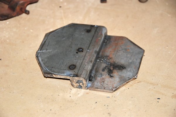

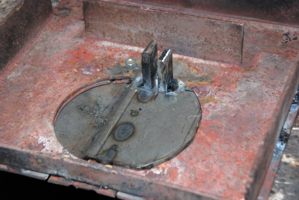

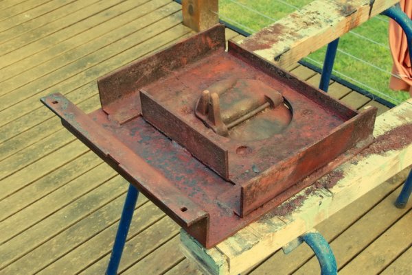

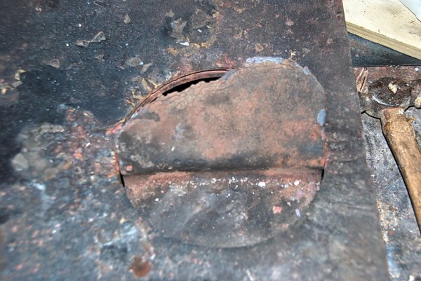

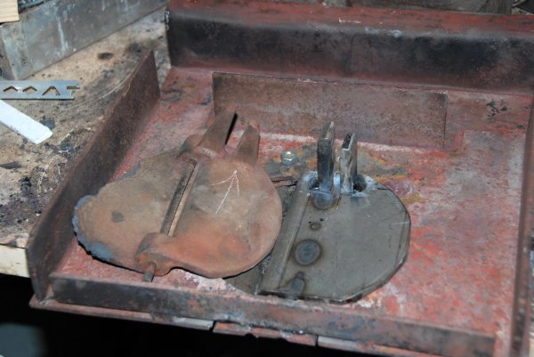

    I have a heater known in Aussie as a Maxitile, so named due to the ceramic tiles set on each side that stay perfectly cool to touch regardless of fire severity. Its quite old and I have alway had trouble with the chimney damper jamming until it warms up. I tried to remedy many times but due to the butterfly being damaged and eroded I determined to try and rebuild it. That I did with complete success utilising bits and pieces I had including a s/s shaft.

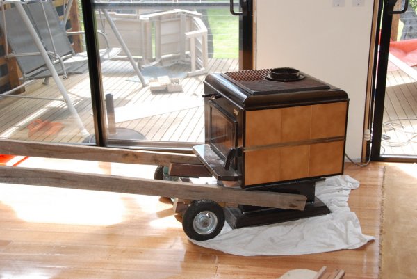

    Note also my method of moving the heater easily and safely away from its home. Im not very good at Pic posting yet but hope these make some sense. 2 flanges joined_resize.JPG DSC_2472_resize.jpg DSC_2513_resize.jpg DSC_2519_resize.jpg DSC_4272_resize.JPG DSC_4322_resize.jpg turning plates attached_resize.JPG 2 flanges joined_resize.JPG DSC_2472_resize.jpg DSC_2513_resize.jpg DSC_2472_resize.jpg DSC_2472_resize.jpg DSC_2472_resize.jpg

    Very nice work on the new plate! :yes:
    I really like the ingenuity moving the stove...me thinks we will see that idea surface here again in the future! :thumbs:
    They call that "git 'er dun" here in the states ;)
