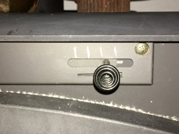

    Its mostly me cutting it down in quarters. So i grabbed some soapstone and marked this out. See here. image.jpg
    Just after I took this I tuned it from 75%open to 25%open but we know that’s not true. Just my air engagement is pretty flexible as I am able to slow this down but UP TO A POINT. A 1/2 loaded stove brings it up past a comfortable temp. Its a weird thing but I don’t feel like Im breaking any rules, just gear-wise this might be ok. It doesn’t last long though. Just flexing.
