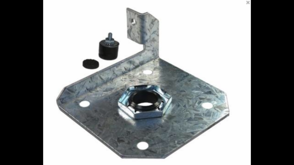

    If your auger shaft is 3/4” in diameter then I would put in the upgraded Nylatron Bearing & End plate. PP4010. The bearing is permanently lubricated and works much bette than the bronze oillite bearing. Dr Whitfield sent out a tech bulletin years ago to all his dealers and told them to do it right away!! Maybe he knew something? LOL
