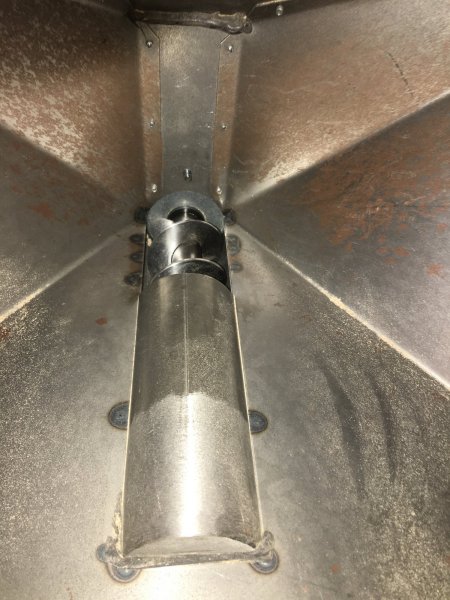

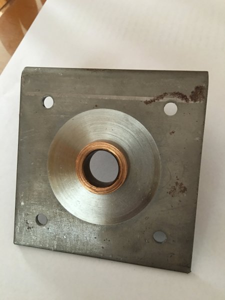

    Pic 1 - old SAE 832 oil impregnated bronze auger bushing

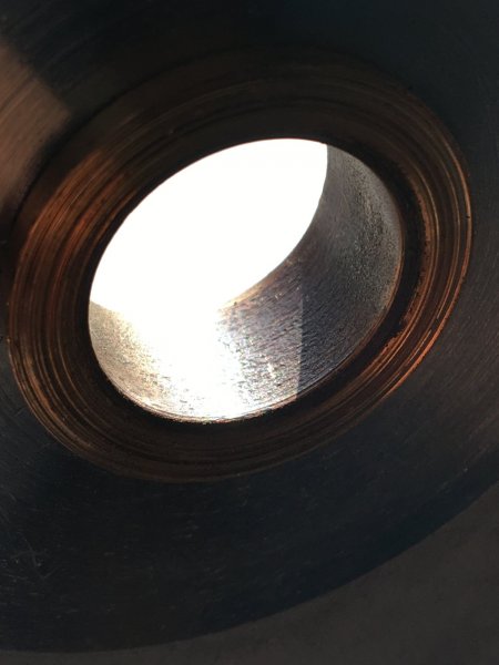

    Pic 2 - Skanky and dirty inside of bushing. This one was crying for replacement because it was squeeking like a mouse when the auger turned! ! !
    Pic 3-4 new Nylatron as shown from inside of hopper.

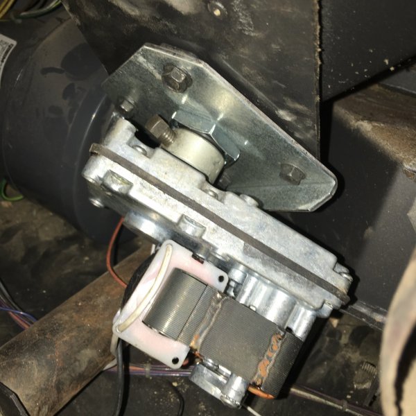

    Pic 5 - new Hi Quality Gleason Avery auger motor and new Nylatron bearing with auger end plate
    Auger turns freely like butter!
