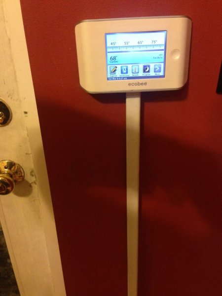

    Hello
    Does a top of the line Hampton GC60 or Enviro M55 deserve a top of the line Wi-Fi tstat?
    Here it is for you to decide. :)
    The install can be smooth if the install location is known and the wiring is planned out.
    This T-Stat is one of the very few that is not only 24 volt but also can be used on a Milli-Volt system with the optional AC adapter!
    Install steps.
    0. Turn off the stove and unplug it.

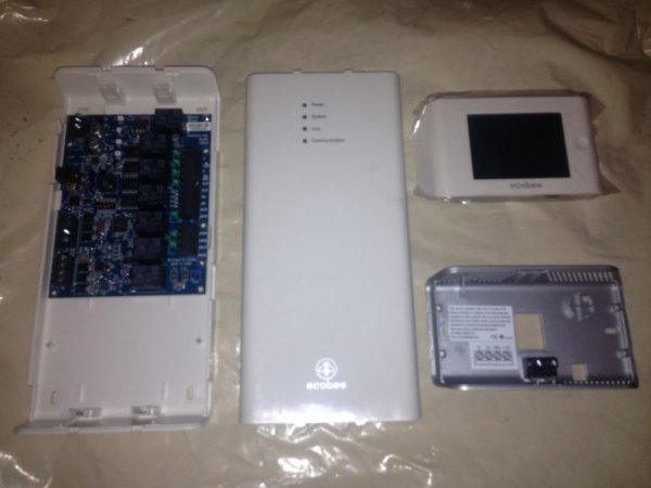

    1. Choose the location and mount the control unit near an AC outlet if possible.
    Use wall anchors or wood screws.
    If you have the optional remote module, mount that into the control unit first.
    Not too close to the stove but not too far away maybe ideal
    2. Mount the Head at the normal height on the wall approx 5 feet off the floor.
    3. Run 4 conductor solid jacketed wire from the control.
    If using hide channel like I did mount that on the wall first.
    I used 5 cond. T-Stat wire from Lowes

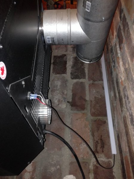

    4. Connect female spade lugs on the regular 2 cond T-Stat wire and plug into stove.
    Run wire to RH and W on the control box.
    5. Plug control box into the wall.
    6. Run the Install wizard on the T-Stat touch screen to choose your Wi-Fi router name and lock it in.
    7. On your Iphone
    Download and install the Ecobee Smart Stat app from the App store.
    Don't forget your apple Appstore password. :)
    8. Set stove to either Auto-On/Off or Auto-Hi/Low
    Now you can either setup a daily program schedule for your stove or put the set temp on hold and change the set temperature up or down to what you desire from anywhere in the world.
    Yes, it does have the short cycle delay for the pellet stove.

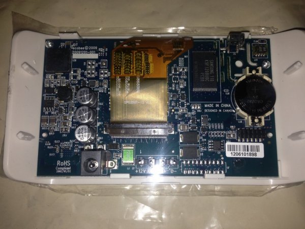

    What I like is the button for the weather forecast and the optional remote module for additional sensors. Also what you see on the wall stat is also what you see on your smart phone!
    1. Indoor sensor
    2. Outdoor sensor
    3. Humidity sensor
    4. CO2 Sensor
    Cool Stat for a pellet stove!
    See pics - Please Click on pic to Enlarge and See Slide show ! ! !
