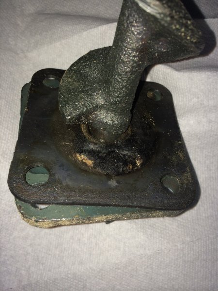

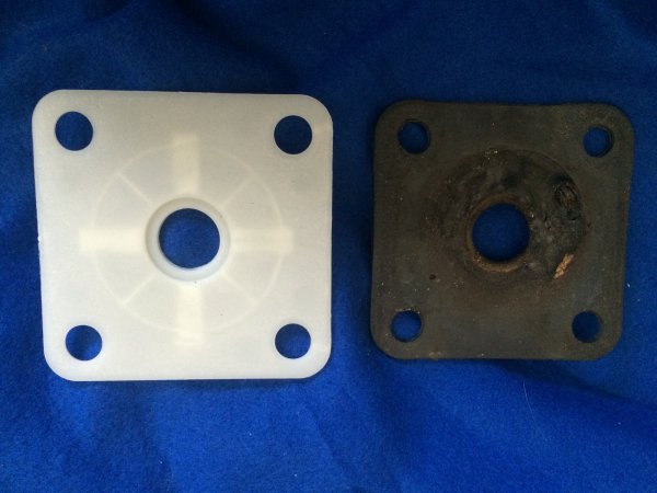

    I find alot of gaskets that are out of shape. The newer gasket seems better and will protect the bearing better.

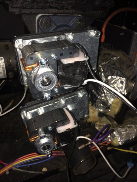

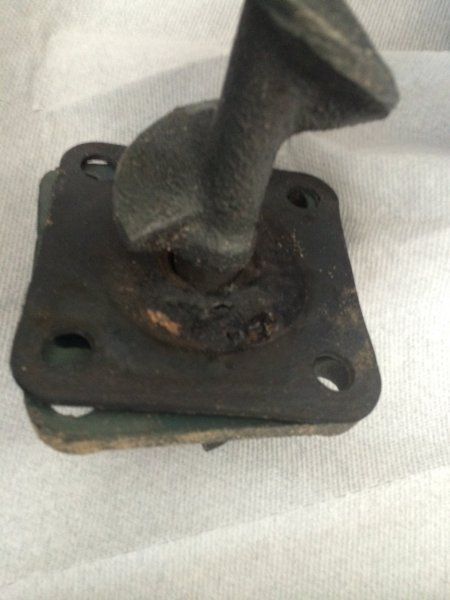

    Pic 1,2 - Auger with old bearing gasket
    Pic 3 - New VS old bearing gasket

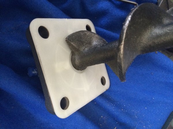

    Pic 4 - Auger with new bearing gasket

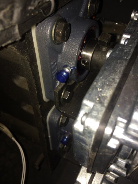

    Pic 5,6 - New auger bearing gasket installed with new auger bearings and new auger motors for good measure.
    Zerk fitting on the left side makes it easier to attach a grease gun.
    _________The new bearings do not come with grease.
