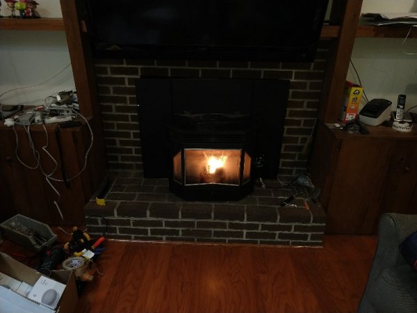

    First startup of the season, was working fine last year (new install). The auger is not running.
    I checked forward from the control board and backward from the auger. The vacuum switch is not activating.
    I went into diagnostic mode and combustion blower, convection blower, and igniter all work. The auger works if I bypass the vacuum switch. If I provide manual suction, the switch activates. I also checked the vacuum pipe into the firebox for obstruction and it's clear. I've also checked for ash buildup//clogs and everything looks OK.
    The combustion blower starts on startup, but the convection blower doesn't.
    Where should I go next for troubleshooting?

    Thanks for the information and suggestions, all.
    I had cleaned everything other than the exhaust/tee at end of season. The installers left very little clearance/slack in the OAK going up the chimney so I couldn't get to the cleanout.
    I've spent ~6 hours fighting to get the stove in a position to work on it with out 4 of those hours trying to get to the cleanout. I finally got to the cleanout and there was.... significant... blockage. Probably about 4" of very clumpy debris and another 3" or so of very fine powder. As far as I can look up the exhaust with an inspection scope it looks clear. Same for the intake.
    Same behavior, though. No vacuum switch activation or auger unless I apply manual vacuum (aka using the vacuum hose like a straw). When the switch activates the auger does run. The switch also doesn't activate while the cleanout is open. There is definitely air coming from the combustion fan.
    I have also checked that the vacuum port/pipe into the stove is clear with some 14 gauge wire. I can see it from the inside.

    So.... :doh:
    The clogged exhaust cleanout was the original cause. But the not working after was because I hadn't reinstalled the ash pan. There was a nice ~24 sqinch or so hole along the bottom of the stove that was directly exposed to ambient air.
    The auger is running now and I'm trying a startup.
    The dollar bill test is fine on the latch side, but doesn't actually grab on the hinge side. The hinge side is unadjustable, though, and the gasket is in good shape.

    Startup went fine. Letting it cool down so I can put everything back together.

    All better. I'm still going to redesign how the surround attaches, but enough for now.
