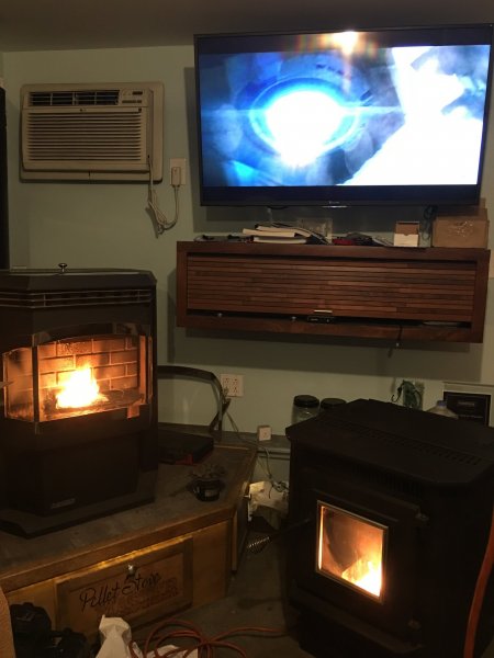

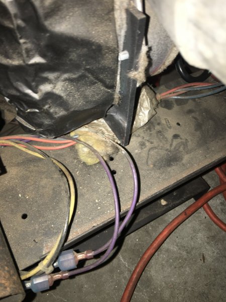

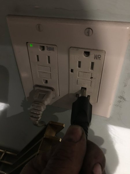

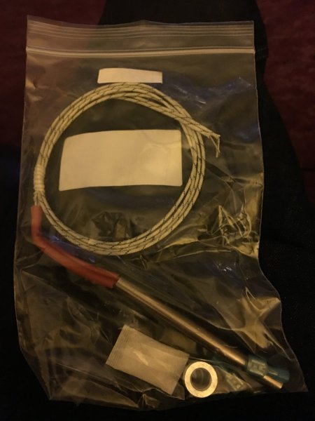

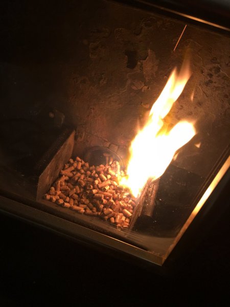

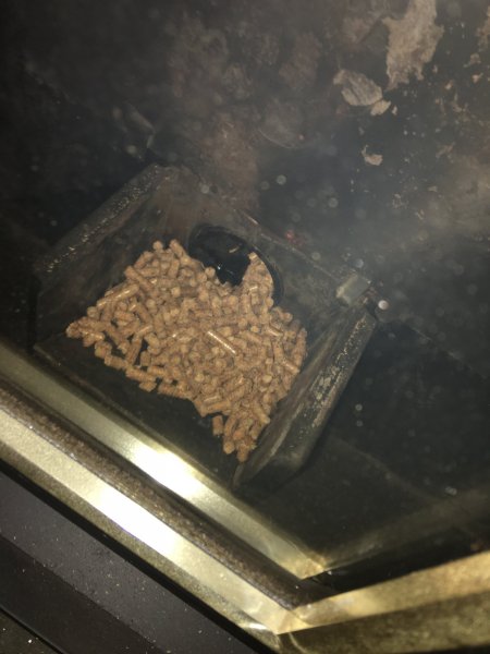

    I am working on this stove. After replacing a few parts I put in a new Igniter and it started fine. So I thought it was working fine. The next time I started the stove, it would not fire up and the tip of the new igniter I put it was not warm! So I put in another igniter and before my eyes, the igniter almost lit the pellets and then blew out! Two bad igniters? Very Strange so I put in a 3rd igniter that was a different brand and then after less than a minute click the GFCI outlet tripped a ground fault! That means a hot lead is leaking to ground! So I looked at the wiring and I saw the problem! Pic 4 - shows the problem
    So The shorted to ground Purple wire caused the igniter to burn out?
    Pic 1 - 3 rd igniter that tripped GFCI outlet
    Pic 2 - Auger motors
    Pic 3 - tripped GFI outlet
    Pic 4 - close up of 2 purple wires going to the lower auger motor shows one bare purple wire!

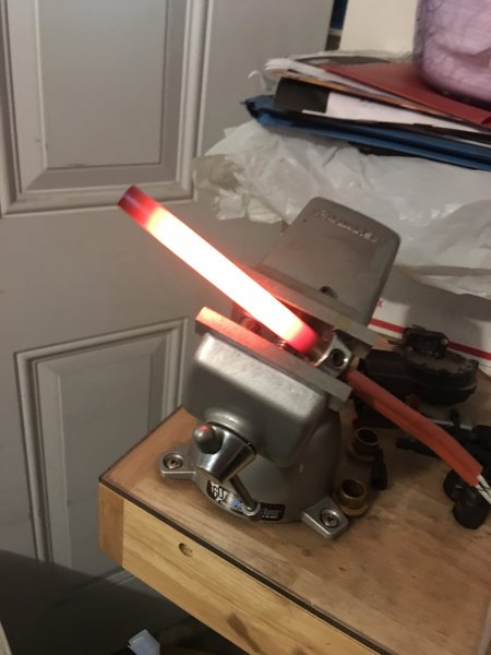

    So I disconnected the igniter and the stove ran for more than 1 min so I put the 3rd igniter on the test bench.
    Well the 3rd new igniter seems to be damaged and not working at the tip.
    I put in a 4th igniter and the GFI still tripped. Therefore I plugged the stove into a non GFCI outlet in my shop and a little after 5 minutes it fired up nice!

    Probably - resistance-based devices don't handle (over-current) shorting well, melts the internal winding pretty quick.

    Yes, I thought the igniter was defective but not 3 igniters!!
    The auger motor wire must have touched the hot exhaust housing causing the insulation to melt!

    When you check your wires, have some wire ties handy and tie up anything with too much slack that could come in contact with and hot metal. Good Luck
