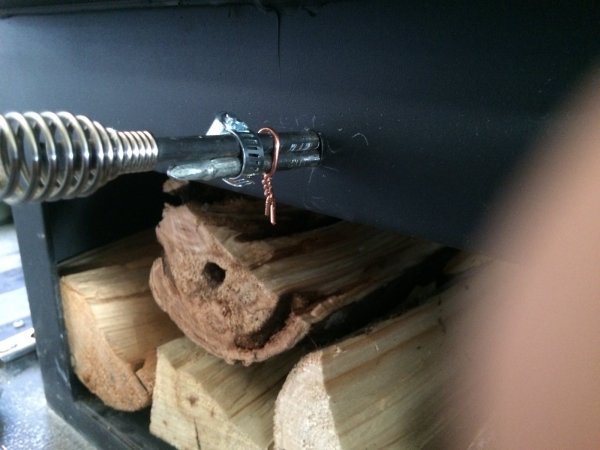

    Hey, guys, was bored so I thought I'd show a pic of my "Super Cruise" mod to the air lever on my Englander 17-VL.
    I bought the stove last year, went through the trials of figuring out these secondary burn stoves, along with marginal wood and much thinking. This year, I got her dialed in and can run it like a rocket no problems. I have it in a mobile home, and the stove top to chimney cap is about 10 feet. She's sluggish when it's warm outside, but not much effort once the pipe warms up.
    Anyways, it seemed to be running away on me this year, not overfire, but too much temp on the flue probe, and a bit much flames shooting up between the baffles. I had thought it was a loose window gasket, but it doesn't appear to be the case. It won't pull smoke in, and it won't let it out or set off the CO detector.
    For some reason I'm sitting there, and I was wondering about the play (up/down) on the air control lever, and lifted it, and got the shock of my life! It simmered the flame down within 4-5 seconds....
    Basically it's just a little rod that keeps the air lever perched up a little better than 1/8th inch higher on the channel.
    Maybe it was made on a Friday afternoon, and it lets a bit much air in, I don't know, maybe they're all like this to help pass the epa test?. I'm not slagging the stove, I love this thing. It couldn't be a better fit for our situation. Just thought it was neat to be able to settle it down on the top end so much, and keep more flame in the box.

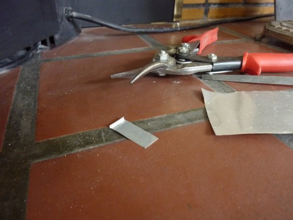

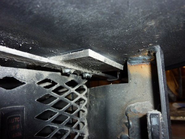

    I did a similar tweak on the Buck. I wrapped a small piece of trim coil around the saddle where the air control rod goes through. This holds the cover plates (mainly the right one) closer to the opening, sealing it off better and limiting the air a little more. I didn't want to pull the plate up too tight so I only wrapped one thickness around the saddle. That was enough to cut the air a bit and make the burn more controllable, and if my wife or SIL was running the stove, I wanted to make it a little less likely that they could cut the air too far and crash the cat.
    Before I put the shim in, you can see a bit of air gap between the right plate and opening.
    Pretty simple to cut a piece and wrap it around the bottom of the saddle.
    papadave and saskwoodburner like this.
