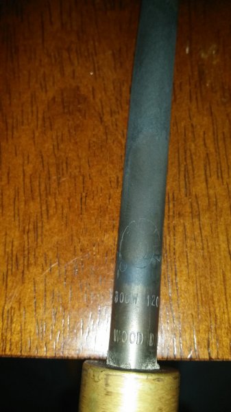

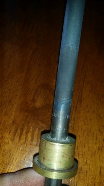

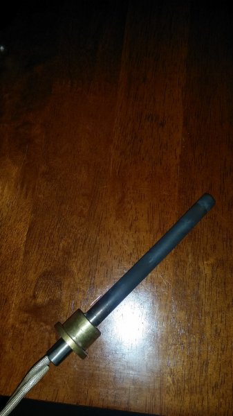

    Here are some pics.
    It says "Wood Dale IL U.S.A."
    It's a 300 watt 120 volt
    Then a couple sets of numbers.
    E 09 01
    And
    HDC19013
    And finally, there is a horseshoe, with a a name around it. But I can't make it out (Tempco? Over a Horseshoe)

    That's a Tempco ignitor......same make as Englander uses. Check their website with the info you got, and/or give them a call direct.

    It's 4" long and about 3/8" in diameter.

    Will that brass collar come off? It appears to be pressed on.

    I would suspect it will press off fairly easy. I wouldn't try unless its DOA though.

    This collar won't come off and is what holds the cartridge in a housing. I will have to get a pic tomorrow. I lit the stove manually, and have it idling on low, just for a little added heat in the living room. Going down to 9° tonight and the Fahrenheit was running on High (level 4 of 5) a lot Last night and never dropped down on low very much. It was just as cold, so having the Enerzone provide some heat, has the Furnace taking a little break here and there.

    Don't know what you used to try getting it off, but did you try heating just the collar w/ a propane torch and tapping with a small hammer or lg. dia. punch?
    EDIT: And since it's toast anyway, maybe cut the ignitor off flush with both sides & drill it out?

    Yep. Heated the collar and tried to twist it with a pair of vise grips and locked in a vise.
    The cut and drill approach may work great. :)
