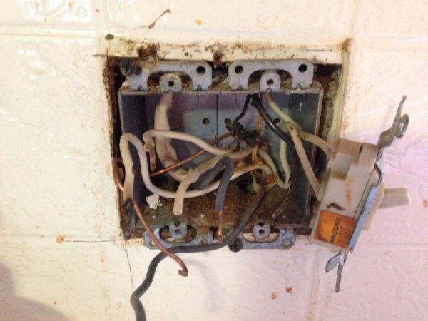

    So trying to fix supper lastnight. A outlet on the other side of the kitchen kept popping.... So didn't really want to get into too much. I made frozen pizza instead. After eating I decided to tear into that plug in. After getting the cover off and insulation out. I found a dead (a long time ) mouse. Nice! Not quite what I was expecting. So I got him out. While going through the wiring in the box. I noticed the plug had gotten hot. And the was a wire nut in there. Find three sets of wires going into the plug in. Nice. So put things back up till today.
    I go turn off the breaker. And break open the box again. So the brought the main power in to the plugin. Then ran another wire to the microwave circuit. The from the original plugin ran another wire for a flouresent light. But inside the box the wire but was loose and all it was in there for was a wire extension. Nice. Wires where both black on the wire nut. Lucky I guess no fire happened. Been trying to fix up all the electrical nightmares that I come against.

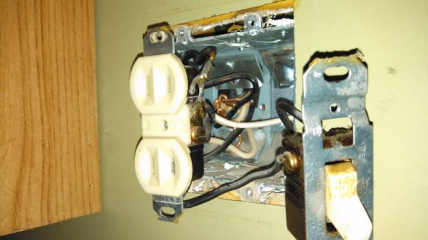

    My brother found a situation that looked like the mess in pic number 2 last fAll when he had an old outlet wear out. Color code was all disregarded and it was an utter mess. I put a meter on it, tracked it all down and reassembled it with the color code right, had to change polarity further down the line but at least now I know he will be able to take care of it if something should happen again.
    Our house is over 100 years old and I have taken most of the old circuitry off line and replaced it with new. But all the lights are still original. On my todo list!

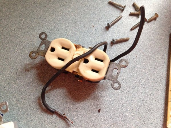

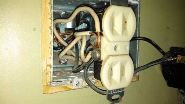

    Here's that setup I mentioned.... someone soldered a connector on and it wouldn't stay under the screw. Screw was lose and what you see is how I found it.
    Have I mentioned how much I love this house?

    Forgot to mention that after I took those pics, I got some tools and put in a jumper from the screw to connect everything.
    Didn't fix the common wire/screw on the outlet, since it was tight, but I will at some point.
    I need to win the lotto so I can bulldoze this place and rebuild the right way.
    Again....Jeesh.
