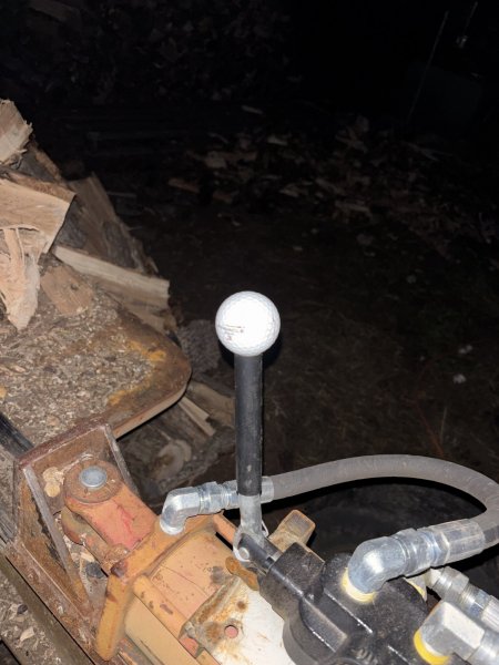

    I will try to get some pics/video tomorrow. I do need to put a lighter spring in the splitter valve, because it is quite difficult to hold the lever in the “go” position.

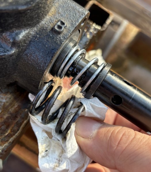

    I got the spring replaced. It’s a night and day difference with the effort required to move the lever. It required serious effort to move before, probably because of some lawyer…
    I can easily move it with a finger tip now. The grease in the detent was some china junk and looked dirty, so I cleaned it out and put some hd red tacky grease in it. I’m happy.
    The black spring is the old one and the silver spring is the new one. Now for some more splitting.

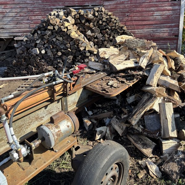

    This is what we got done in the 10-15 minutes we had last night. (The pile in front of the splitter) IMG_3247.jpeg
