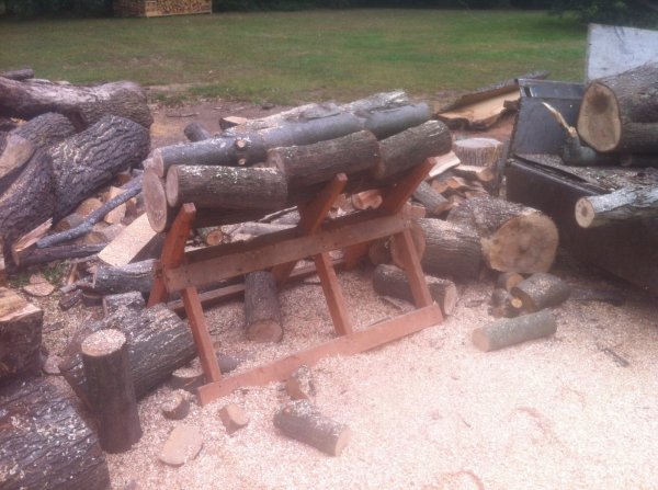

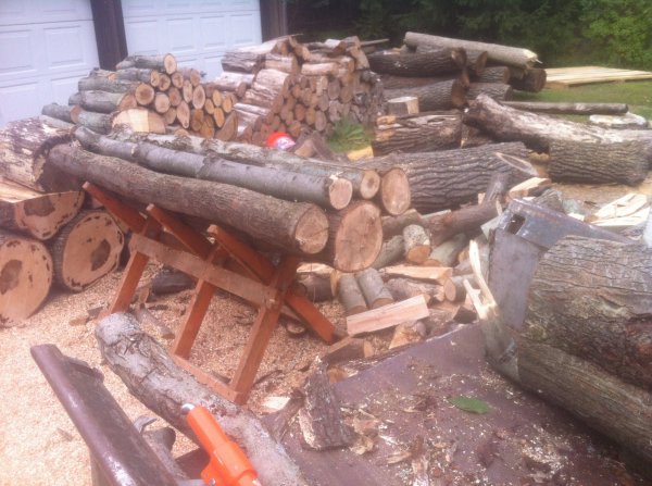

    4. A sawbuck - great tool for gang cutting piles of branches.

    Shawn, can you remind me how you spaced the verticals for your sawbuck? You had a slick system with the middle one off center.

    Thanks Mike! The short side is 16" on center - which is the length I like to cut my firewood to. The thinking was, I could use that to "eyeball" my lengths, and that it could support a slightly oversize piece (17-20") for trimming. That said, I rarely use it that way. I mark my lengths ahead of time on the log, and position them on the sawbuck where I won't cut into the legs.
    The large side is 24" OC, which was simply the remainder - all the parts are made from five 8' 2x4s cut in half.
