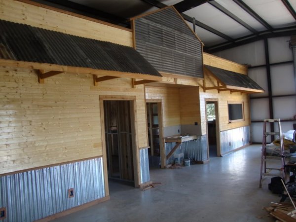

    i guess this is kinda the look i am going for. except my corrugated lines would be horizontal.

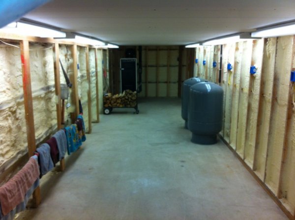

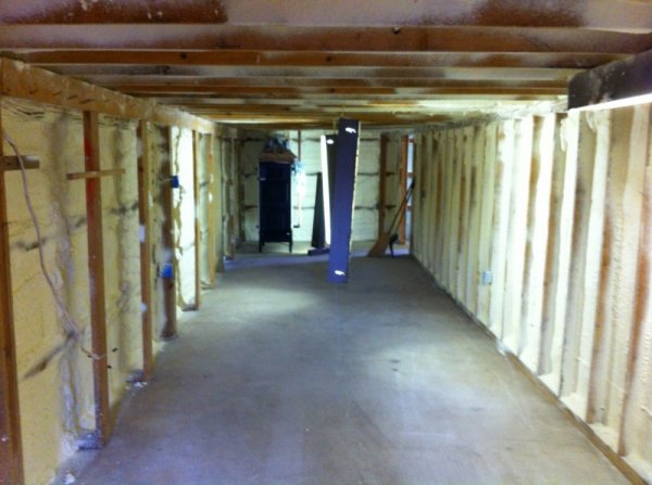

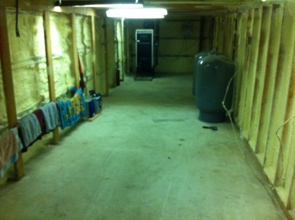

    got started this weekend. the whole barn was only one circuit. rewired with seperate lighting and outlet breakers. they originally mixed 12 and 14 wire so it was more work than expected sorting that out. outlets every 10' on the left wall, 4' on the right. cieling is up. see before and after pics. the back by the boiler isnt really as dark as it looks in the pic, the lights are just that bright up front. should be really nice when its done. gotta get the wife new double front doors for the house and i will repurpose the old ones. i have a door for the opening to the right of the boiler. need to frame it myself if i cant source one otherwise. still figuring out what to do with walls. neither lowes or home depot can/want to order the 10' plywood for me. nor does the one lumber yard i stopped in at.

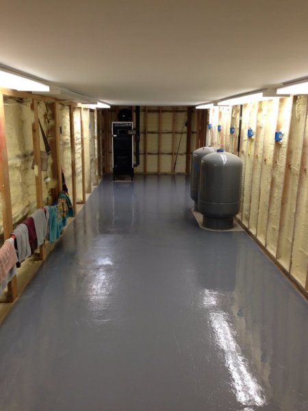

    Guess who is FINALLY ready to throw down for walls?
