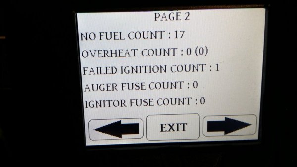

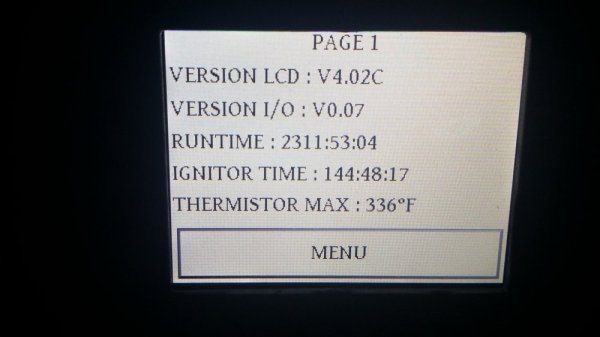

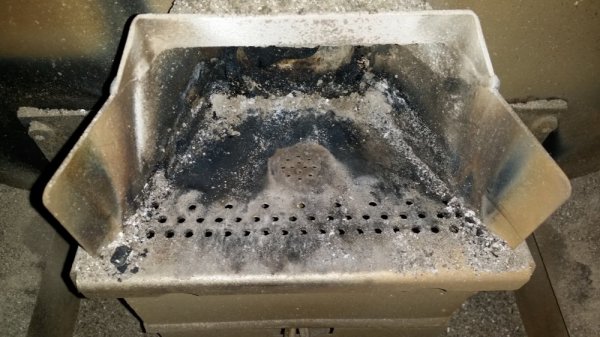

    Is your ignitor area where mine is, it's almost dead center in the pot (small round patch of holes). There is a small speed bump of carbon that builds up behind it, but so far, it has never made its way up to the ignitor.
    As imacman stated, running on low is worse on a pellet stove. It's not gonna kill the stove, but the burn dirtier that way and the "bump" of carbon will build faster with less heat.
    My ignitor has ran for quite some time now and I believe it's the same style cartridge as yours, but your stove has an air pump? It's probably at 145 hrs now.
    Going to look in the manual, but I thought that all the Enerzone Euromax/Drolet Eco -65 stoves tried to relish if it sensed a misfire? Mine will try to start 3 times. After 3 attempts, it will shut down and throw a code.
    Only once did the stove miss it's first ignition and that was last year when it had burned a ton of fuel without touching it. It still lit, but did not do so on the first attempt.

  16. wildwest
    29,498
    136,884
    Wyoming high plains
    Thats exactly where it was! I had missed it.
    I had no idea. Thanks,
