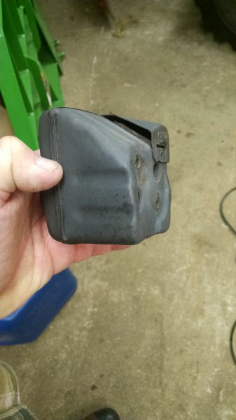

    Some friends of mine (would be inlaw's if my flipping kid would pop the question) own a resale shop. He calls to offer me a 7 month old saw for a song. Well I sang, like most of this chorus here would.
    So I tear into it to do a muffler mod thinking it would have a cat to gut. I was surprised to find a empty can with a exhaust port with a deflector welded over it. It looks like the port is already bigger than the carb so what now ? Caps from the carb are in the trash. Anyone mod one of these ??

    I'll give you some advice: Send it here & I'll break it in for ya! Nice find. Muffler empty & port not restricted, tune it & run it like ya stole it! If it needs more send it for a port job. Those seem to be really solid saws.

    I'm no saw builder, but I have ran an echo 800 before. Put that gutted muffler back on and tune her in. Those saws remind me of the old McCulloch or pioneer saws from the eighties, lots of torque! It will pull a 32 or 36 inch bar with full comp in softwoods with no issues. They don't have the chainspeed of the Stihl or Husqvarna or dolmar. Cs800 is kinda heavy but I think one would last a lifetime if taken car of.

    The man of hour !!!! What are your thoughts on this ? I haven't run it yet as I took to dumping the fluids and minor disassembly for inspection, limiter cap removal ect. I don't expect any issues though. I'm hoping to get it together this weekend and fire it up set the carb ect.

    Sounds like a great place to start.
    I haven't handled an 800. I'd venture to guess they're a larger brother to the 670/680, which I've ported a few of. A bit heavy compared to saws from Stihl and Husky, but build quality is 2nd to none. Taken care of, I think they'll last forever.
