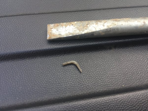

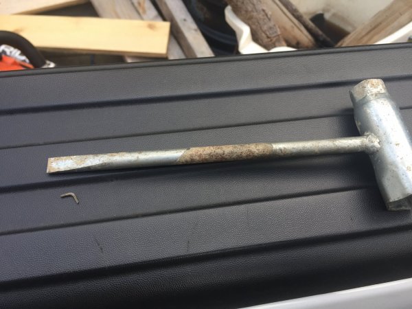

    IMG_7028.JPG IMG_7029.JPG Hi all,
    I went to use my saw the other day and found that the truck box it was in all summer had taken on some water. I believe the saw was never submerged, just the tip of the bar.
    Anyway, I tried to start it for a bit and then gave up. Today I looked at it closer. I have confirmed that it has gas and spark. When I had the spark plug out, I noticed something riding on top of the piston. It seems to be a bit of silicone. Pictures of the object are attached.

    That is an interesting piece of stuff to find on the piston. If it is silicone I'm guessing it was excess that squeezed out during assembly. The only thing that I can think of if you have spark and fuel is timing is off or the crank seals went bad. My uncle has a cs6700 that ran flawless until last fall when it stopped on him cutting down a dead ash tree. We tried everything but it turned out to be bad crank seals. One other thing is the needle could have dirt on it and the fuel is just running through and flooding the saw keeping it from starting.

    You sure that's silicone like? It looks like solder to me, like someone measured squish on the saw and left it in there. Did you buy this saw new?
    Start with a teaspoon of mix in the plug hole. Does she fire and die then?
