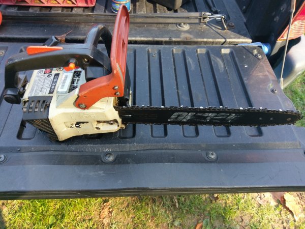

    Well, I bought an eBay saw as a fixer upper for my nephew. It will be his first chainsaw. Was trying to do a budget build, but things don't always go as planned. It felt as though compression was OK and it would fire up and sputter briefly.
    The saw after a pressure washer bath...not too bad a shape.
    There were a few janky bits on it

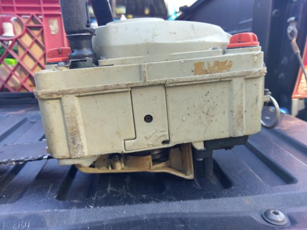

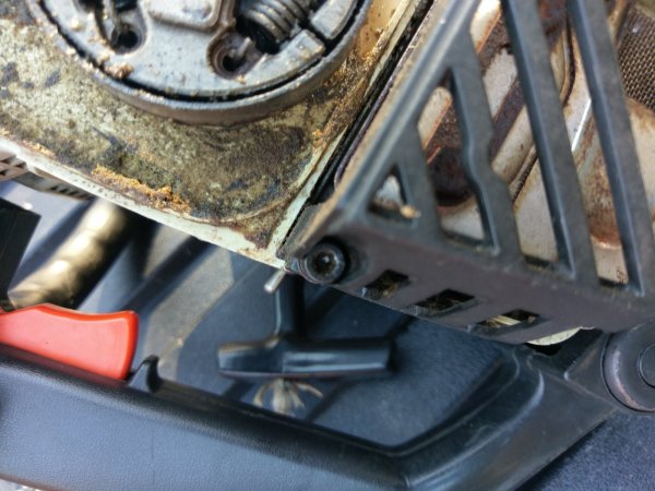

    Broken muffler cover and incorrect screw

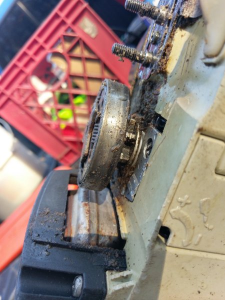

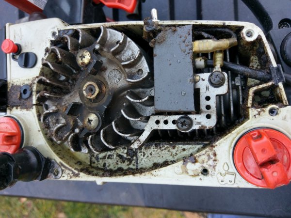

    Started tearing down to further diagnose and clean....

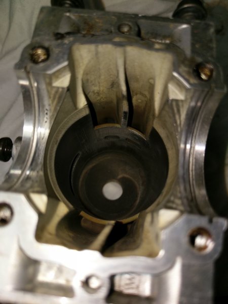

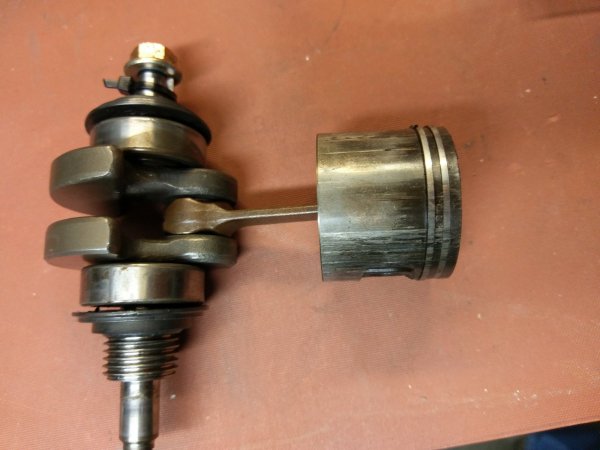

    Broke a muffler stud off trying to get a peek inside the cylinder and found this...ugh

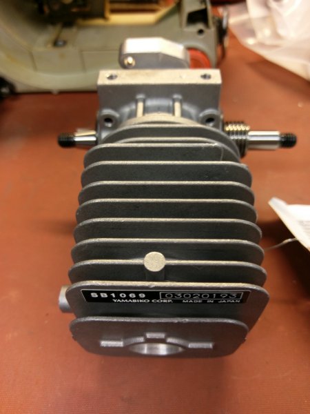

    I decided to go ahead and buy a new shortblock for it...I hate giving up. Whole other pile of rubber parts and some small bits on order also to bring it back to like new condition. I will have ~$220 in it when all said and done. Glad I wasn't looking to make any money on this!
    :makeitrain"
    I will update progress when the Short block and parts arrive.

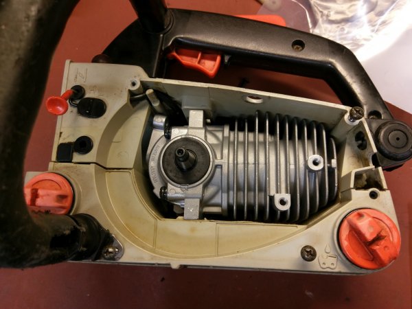

    New SB showed up yesterday. Remaining needed parts on order.
    Should have rest of needed parts this coming week.
