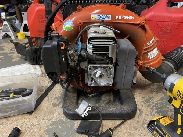

    Echo PB500H backpack blower that’s about 14 years old. Over all, runs well.
    I’m running into an odd issue where after running for a while at full throttle, the RPMs will randomly drop, then pick up. The longer I run it for, the more pronounced the drop will be. This afternoon, it got the point where the unit would almost stall unless I backed of the throttle.
    Kinda stumped on this one. Wondering if maybe a fuel line is split and it’s starving for fuel at times?
    Open to any suggestions.

  11. Skier76
    Skier76
    Dec 27, 2014
    2,875
    15,654
    CT and SoVT
    Well, bought an OEM coil online, installed, fired right up! Ran great! Then started doing it yet again. Sigh. Back to the diagnosis board if there is such a thing…
