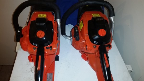

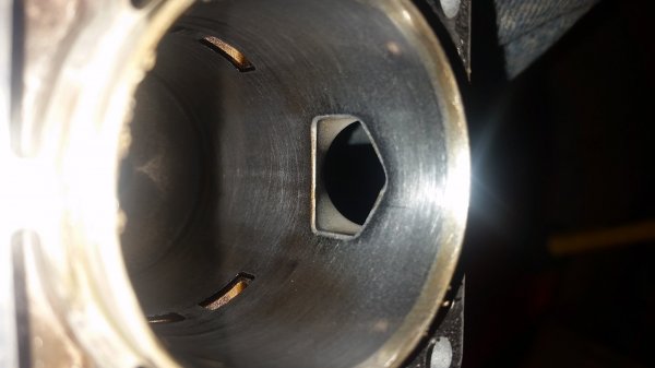

    Name that cylinder. Lol. Got a pair on my bench now.
    Barcroftb likes this.

    guessing thats a 490/500...i havent been into them. we getting to see a build thread on this?

    Yes sir. I'm trying to figure them out now. Look at this intake!

    Here's the canidates. When I get one closer to done I'll do a thread. Most don't like waiting while I slowly maneuver threw a saw. Lol.
    Barcroftb and fordf150 like this.

    the little bit that i have seen of the echo cylinders will make you wonder sometimes. they definately have some different ideas

    That looks.... different. Kinda hard to tell without my grubby mits on it but it looks like they left some room up top as well.

    120/131/81 was the numbers! And that 81 at the tip. But I'll get to all that in the build thread. Lol.
