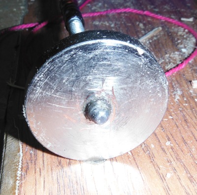

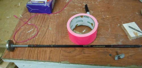

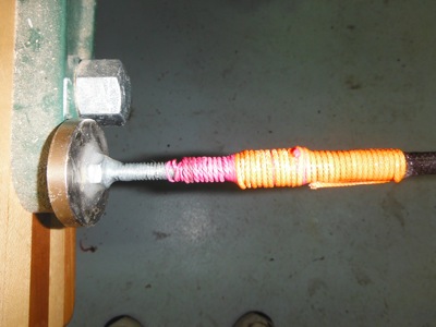

    Got the earth magnets (apex magnet)
    Link
    got one 1-1/2 diameter & two 1" diameter.
    the 1-1/2 " worked the best, stronger attachment to the bar.
    the 1" work ok but they came off much easier than the 1-1/2 " one.
    Strong little magnets !!!
    Be careful with them, easy to pinch a finger & get a blood blister ;)

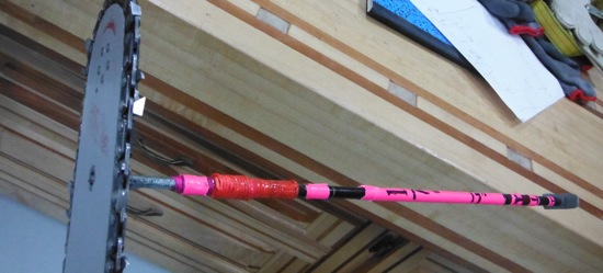

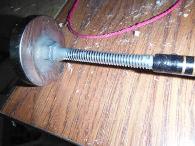

    Epoxied it to a piece of fishing pole. (cut off a 1/2 - 20, 3" bolt)
    Left a nub stick thru that fits in the hole in the bar. (can't slide)
    lashed, epoxied, added some flo-pink duct tape.
    I'll test it soon
    Nice features:
    I can switch sides of the bar easy &
    fast on & off.

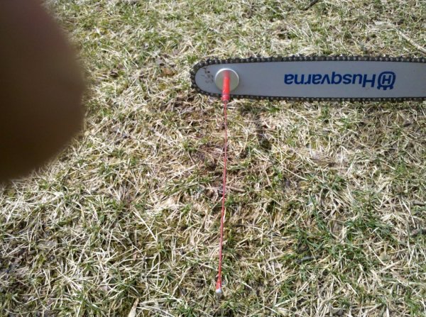

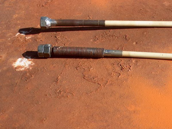

  16. bogydave
    37,217

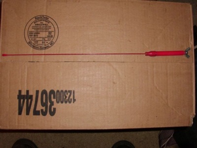

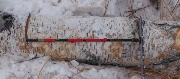

    The old one was attached with a stud & wing nut,
    Just used it 2 days ago.
    graphite , still working , 25 cord + measured with it.:
    HDRock gave me the idea of the magnet.
    He has one with a spring, whip antenna
    BillinTX has some he made one with a spring too.
    3765-3e84724d1c927e946cce963c2d8bfef9.jpg 3764-1b1a78a353569afbfab1a7d46579e288.jpg
    BeetleKill is in the process of making one using
    one of those spring door stops gizmos. Another good idea.

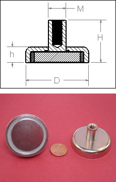

    Great job Dave! KJmagnetics is sending me a few, they look perfect for what I want to do. PLUS, no drilling into my bar= win-win for me! :)
  18. bogydave
    37,217
    What size did you get?
  19. Beetle-Kill
    Beetle-Kill
    Nov 23, 2013
    4,102
    19,558
    Near the Divide, Colorado
    1-3/4" od with the 1/4 x 20 female. Did it online, so hope they show up as expected.
    Now, here's what I really expect out of them- max. 50lb. pull off. They may rate 125 lbs., but they don't qualify the thickness of the backer steel.
    Mag drills don't hold well on 1/4" plate, I suspect this magnet won't hold to spec. on a chain bar. I'm good with that.
    I'll adjust.
