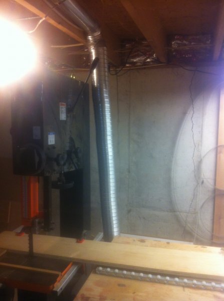

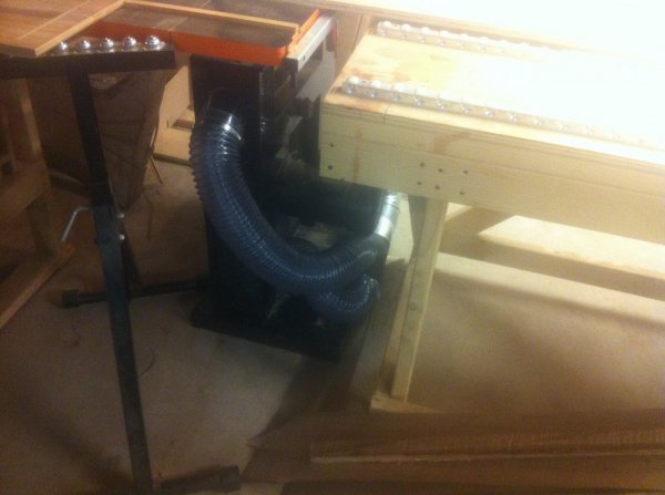

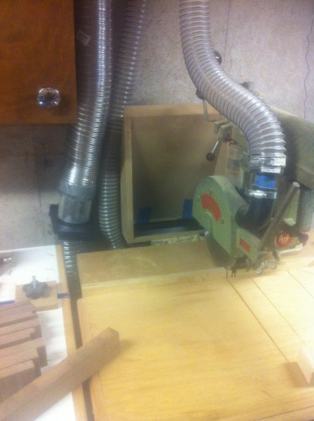

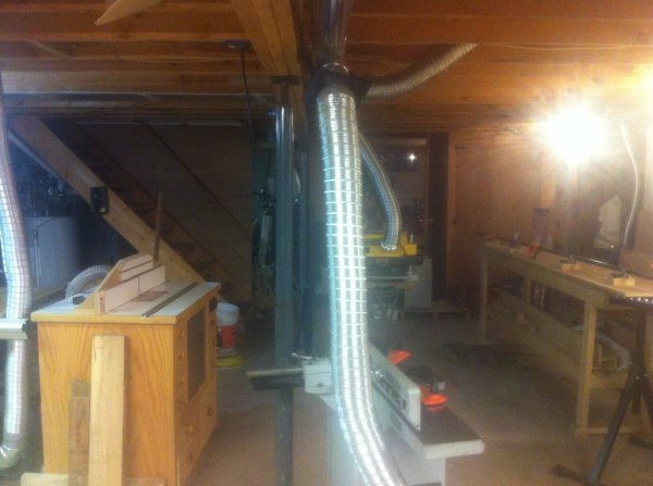

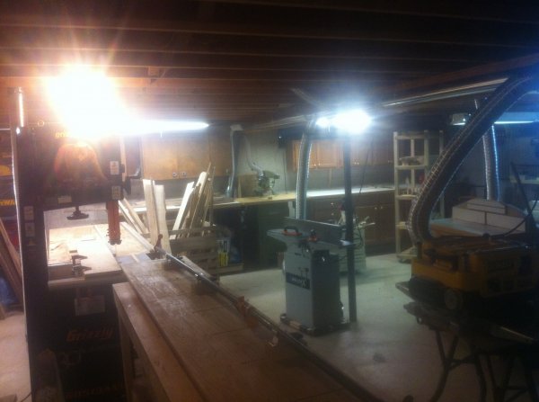

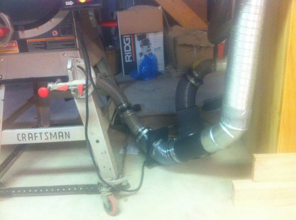

    So I went on a little tool binge when i got my tax return.... :whistle: I found a nice deal on CL for a jointer, and when I got there the guy had a bunch of other tools he wanted to get rid of and he wanted to do package deals... So I ended up coming home with a dust collector too.
    Until now I've been using a shop vac, and I had tie-ins on all my machines for that. And that's been one of my biggest hassles around the workshop - moving it around from machine to machine.
    I got a box o' dust collection parts with it, but it was all 2" stuff. But as I was designing the system in my head, I just couldn't resist running 4" lines to all of my machines. So I ended up raiding the HVAC and dryer hookup displays at my Home Depot. I could build the system that way for a fraction of the price that my local woodworking specialty store would have wanted to do it in plastic.
    I ran a 4" trunk of round duct down the center of my workshop with Y fittings for each tool. Then I made the drops with 6' and 8' dryer vent ducts. I found that most of the metal couplings could make a nice fit with the 4" plastic tool ports; airtight in most cases.
    And that's probably the biggest drawback - it was pretty leaky at first, especially at the joints. But that's why God created Duct Tape. :) Plus you don't need as many hose clamps that way. ;)
    It's probably a little noisier too, but its working beautifully. I have blast gates at each tool so I can collect from one tool at a time, but I think with the additional suction power I could run 2 or 3 at a time just fine.

    So, where's the actual dust collector?

    It was in the second pic, tucked away in the corner. I'm not sure if grounding is even necessary, since its metal all the way back to the machine, which is itself grounded. I've been running it for about a half hour and haven't got any shocks from it like I would from the shop vac.
