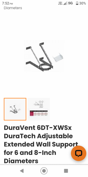

    I'm installing a DuraVent brand chimney and I have to clear a 12" eve ..from the research I've been doing I need the extended wall bracket .
    I was wondering if anyone's used this and how it worked out ?
    I can't find anything about it on the web
    Thanks

    Ernie, I didn’t use that bracket but used a 45 degree elbow to offset the pipe on my shop.
    Edit… after looking at the picture I should have used it first from my through the wall
    Pipe at bottom and then straight shot up. I’ll have to try that when I clean it next time.

    I was trying to avoid using any fitting or going through the eve ..I was hoping if this brackets worth the price it would be a straight shot up past the eve .

    I'd also lean toward using a 22* or 45* fitting(s) over the extended bracket...the bracket means you have a longer run of horizontal pipe through the wall and that can cause draft issues and smoke rollout when loading...unless maybe you have a very tall chimney that will overcome the horizontal...but its always best to have as little flat runs as possible.
    Wait, now that I think about it, I don't think you can do what you want, you would have to have an extended support bracket too, and I don't think they make those, do they? That extended bracket you found is for the pipe after/above the 45*, and before going above the roof line...

    I believe this bracket would be the extended bracket to support the T instead of the traditional mounting bracket that's close to the wall .
    Does the 45 make it harder to run the brush up the chimney to clean it ?
    I was thinking if I used the extended bracket to clear the eve it just have to use a 2' piece of pipe to get me from the T to the adapter inside the wall .
    Would a 2' horizontal run be to much ?
    Thanks
    Ernie

    You have to use a support bracket under the tee.
    A Sooteater will go right up through there with 45's no problem.
    As far as "too much" horizontal...depends on your chimney height, stove model, location, elevation, etc etc...it may be fine, or may not, hard to say for sure... more horizontal is never better though.

    I'm sorry, you are correct...I've not seen that setup before.
    Doesn't look like overkill by any means...do you get much wind where you are?
    I personally would still use the standard bracket with a couple elbows...but that's just me and my 2 ¢.

    I do have some pretty good wind storms from time to time but I plan on also using a bracket where it passes by the eve which would be about half way from the T to top of the chimney .
    Thanks for the info !
