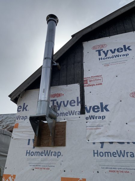

    Outside progress (yeah, I know the housewrap is a mess)

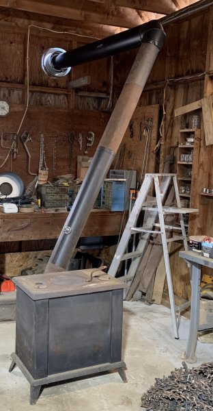

    Only one fire so far, but it drafted well. I might move it closer to the wall, reducing the angle, but for now it is fine here. This was my first experience with both triple and double wall pipe. Overall happy with how it is, for now.

  8. KSPlainsman
    KSPlainsman
    Jul 26, 2022
    827
    4,048
    Kansas
    Can I make a suggestion? If there's already something doing this I don't see, my apologies, but I would suggest running a piece of wire, or that metal strapping with a lot of holes in it, around the pipe, by the 90, and run that up to the rafter, just to help support things a bit. Expansion and contraction will cause that single wall to move a bit, in my experience, and I'd hate to see that give out, being that it's at an angle like that. Otherwise, enjoy the heat! Oh, that's also exactly how my single wall goes into my triple wall.

  9. Flamestead
    Flamestead
    Dec 7, 2013
    2,156
    10,908
    Windsor County, VT
    Yes, it looks a bit sketchy, but I do have a wire up there. I plan to make it two wires, each off at an angle, to eliminate any potential side to side movement if bumped. Quite a few screws in place, too.

  10. KSPlainsman
    KSPlainsman
    Jul 26, 2022
    827
    4,048
    Kansas
    Seen the screws. As long as you have a little support, it should be fine. I just notice that my single wall starts backing out of the triple wall a little bit, over time. I'm in a habit of bumping it into the triple wall once a day, just because. Nothing major, only like a 1/4" maybe, but I only have 4 ft vertical and 2 foot horizontal before it goes into triple wall. So, there's not a lot of weight in mine, plus no angle. If you have a wire up there, that should be good though. 2 would be better piece of mind. :yes:

  11. billb3
    10,206
    52,579
    Those Tempwood stoves sure were popular in New England. One of my sisters still has/ uses one.
    Flamestead likes this.
  12. Flamestead
    Flamestead
    Dec 7, 2013
    2,156
    10,908
    Windsor County, VT
    This was my in-law’s, and then was our primary for 10 years. Has been in storage a dozen years now. Dead-simple design.
